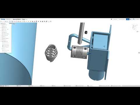

In a project I have a spring that is meant to be part of a handle. In the part studios I have assigned a mate connector to the center of the spring and I have assigned a mate connector a point in the handle where I want the spring to be located in the Assembly. In the Assembly, the mate connector of the spring is no longer located in the position I assigned it to in the part studio. This misplacement does not allow me to position the spring along the handle. What have I done wrong? Is there a better method to accomplish this assembly of those two parts? - Scotty

    Thanks for your response and solution. After attaining the desired result following your advice and then continuing on I noticed that I had two spring connectors; One in the assembly and one in the part studio. Evidently I did attempt to join the handle and spring in the part studio. Perhaps assigning two like connectors to the same part and then attempting to join both to one other part was the source of the problem rather than the transforms. I agree that the part studio would be the better place to do it, reasoning that they are essentially one part and perhaps avoiding some complication/clutter in the assembly (at least for this novice). - Scotty
    Yeah I created both the spring and the handle in the same part studio, assigned mates and connected them there. Worked as expected but I think there's no reason not to create all the parts in their own part studio and mate them in the assembly. Avoids confusion and keep the assembly as the mating medium, perhaps as intended.
