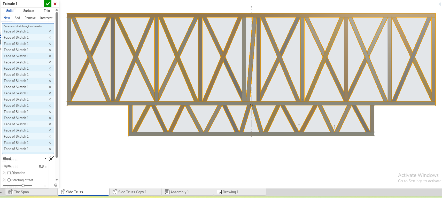

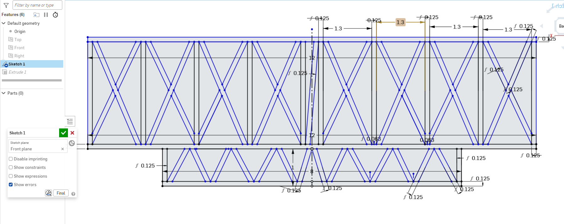

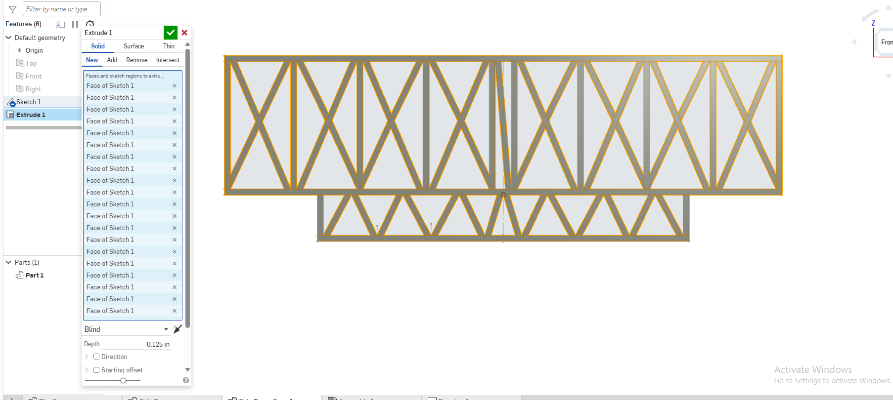

    I came to this post because I was seeing the same problems with my students who are making bridges. Most were extruding their side trusses and seeing one part. A few students were seeing the side trusses show up as multiple parts, which made them a bit more likely to have problems later when adding to the assembly and accidentally moving one part, or needing to move the entire side truss.
    My discovery is that some of the sketches have mistakes that don't show up easily to the naked eye. If you look at the sketches I included, there is almost no visible difference between the first and second one (aside from the fact that one set is from the front view and one from the back view…my screenshot oops). An extra line here or an extra line there. Maybe two lines drawn over the same exact spot. When this happens you don't really have an error or anything red, but you do see some tell-tell signs like a darker line in one spot. or maybe some constraints removed that really need to be there.
    I figured it out by making a copy of the problematic sketch and deleting the first extrude and trying again. About 8-9 faces in, I saw the preview look multicolored so I unclicked the last face and tried others. I extruded ONLY the faces that did not result in the entire extrusion becoming multiple parts. When I looked closer at the sketch, I found little "minor" errors that would be easy to miss. It actually took me several minutes to fix all of the little mistakes that were present. The end result was only minor in changes overall, but it resulted in parts that could then be extruded as one part.
    I guess I will look at my students' work a bit closer in the future to see if I can find their errors that are causing issues. I think that many times it is due to having extra lines underneath other lines or crossovers.
    extrudeMultiple.png extrudeMultiple2.png extrudeSingleSketch.png extrudeSingle.png

  • eric_pestyeric_pesty Member, pcbaevp Posts: 2,605 PRO
    Also a good example of why breaking down one complicated sketch into multiple simpler ones makes your life easier…
    Extrude the outer frame first, then add trusses and braces using linear feature patterns.
