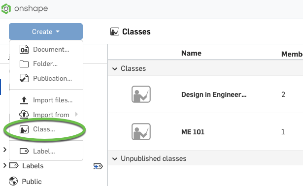

Built specifically for the needs of educators, Classes & Assignments provides an easy way to manage your class rosters, assign documents, and receive submissions from students. Educators, once your account has been upgraded, create classes quickly using the familiar blue Create button, add students to your roster, and publish the class.

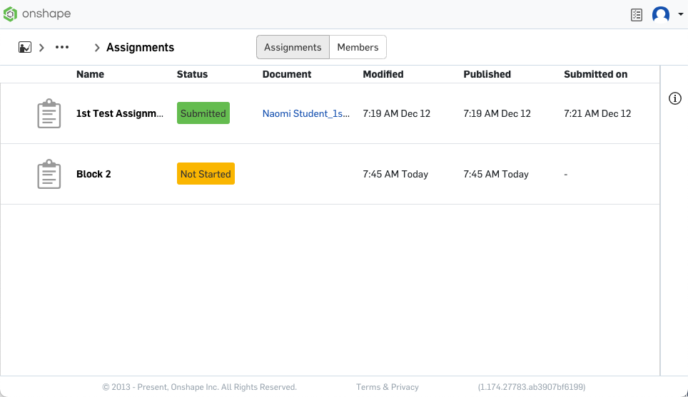

With the latest update, students gain the ability to effortlessly navigate to your class, streamlining their access to assignments and simulation. This enhancement facilitates a quicker review of the work at hand, enabling them to dedicate more class time to honing their design skills.

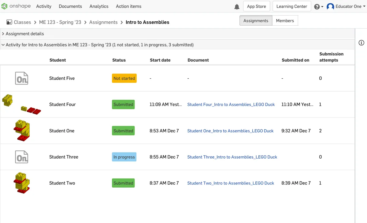

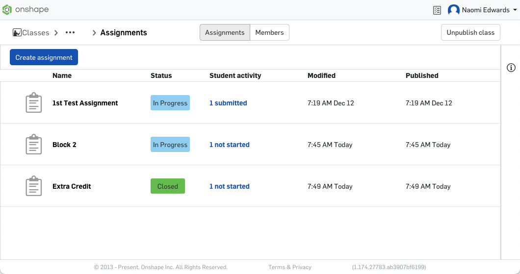

Educators will now enjoy a comprehensive overview of assignment statuses for all students, gaining the ability to efficiently monitor progress and close assignments once completed. This streamlined process simplifies the student and teacher interfaces, offering a more seamless and intuitive document management experience.
Effortless Grading with Assignment View:
Grading is now more convenient than ever for educators using the assignment view. This feature provides a clear snapshot of each student's status, indicating who has submitted their assignments, who is still actively working, and who has yet to open their assignment. This comprehensive insight eases the grading process, making it a more efficient and organized experience for educators.

    You can, if you want, set up classrooms.
    Documents can still be created in the normal way, just make sure you select 'owned by be' before creating anything.
    To create a class hit the create button and choose 'Class…'
    From there you can add students to a class, and or other members of staff. Any work the students do in the class section, (not in the owned by me' section is automatically shared with you. Assignments can be set up to so students can submit work and help keep your stuff organised.
