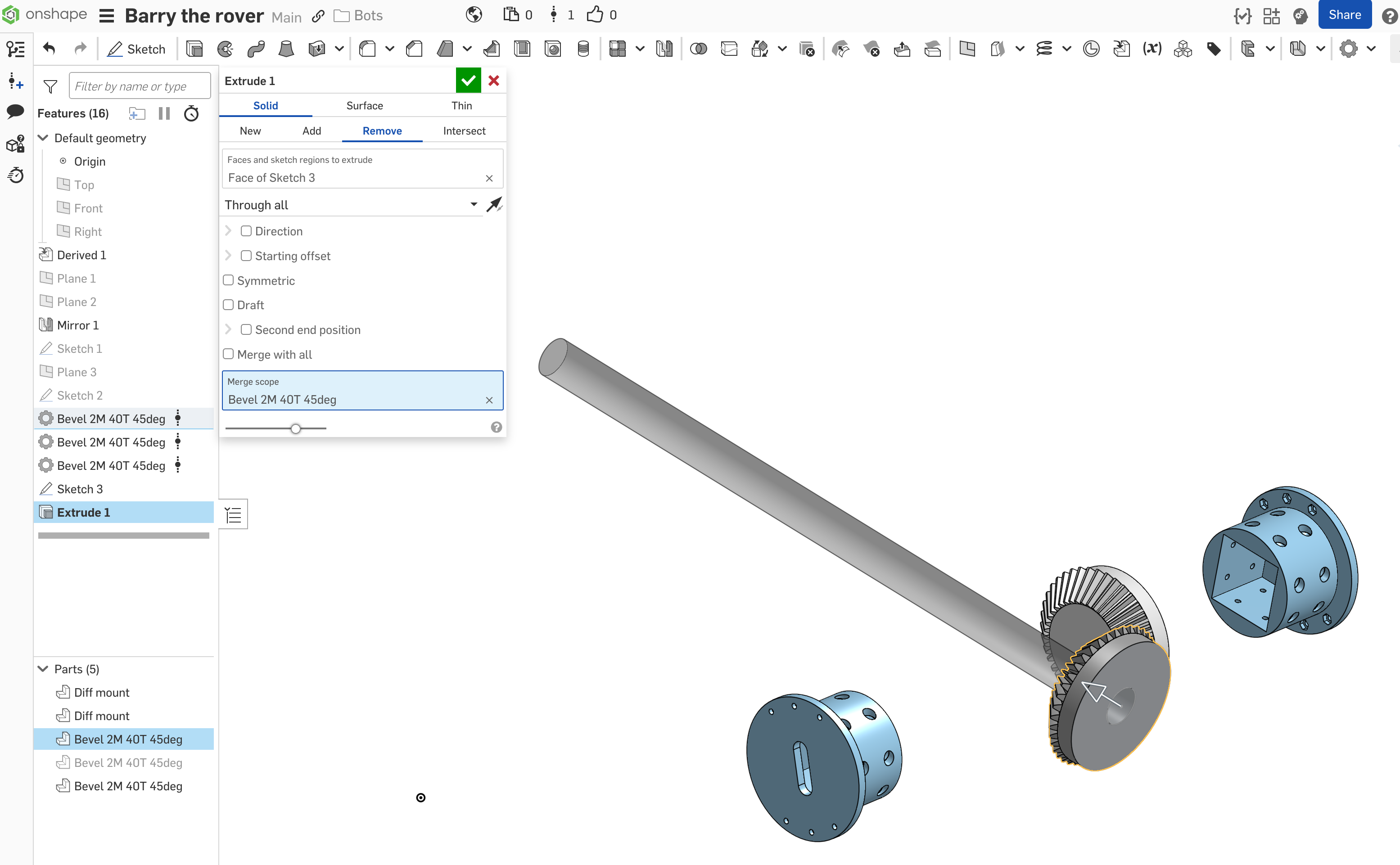

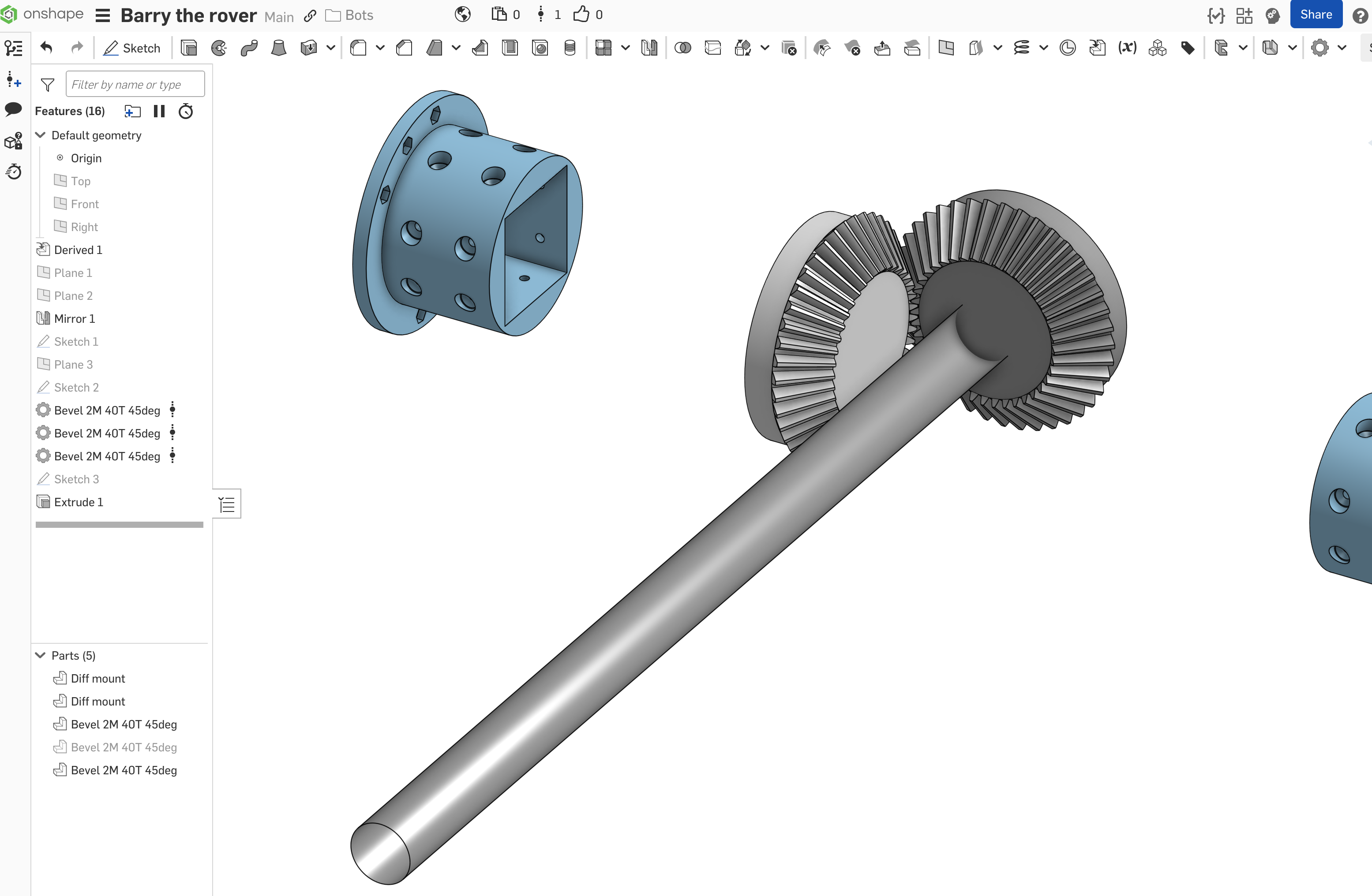

    Hi there. Thanks for this great script! I'm trying to model a simple differential with three bevel gears, which seemed to work well enough. When I tried to punch a 22mm hole through the middle of one of the gears I get weird artifacts where it somehow generates a face around the extrusion and there is still apparently a surface over the face of the gear that is not removed. Any hints?!
