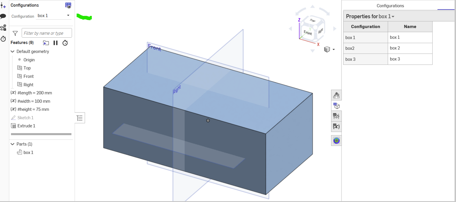

  • glen_dewsburyglen_dewsbury Member Posts: 1,120 PRO
    You may want to try configurations instead of copying parts.
    https://cad.onshape.com/documents/dce3c5f6c9717f40901277de/w/fcaab14d969087547cdfbe2a/e/e29a9f839d6776d9774cc5d7

    By the way, The variables can be changed two ways. Change can be made in the table on mas. When you select which box to view the variables for that part can be changed in the feature tree with out opening the configuration list.
    It's not necessary to include variables in the feature tree but it provides nice column header names.
