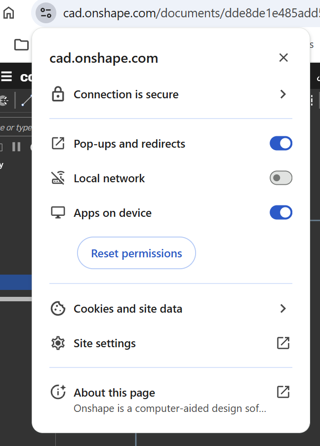

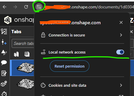

  • casey_wincasey_win Member Posts: 2
    If your using Google Chrome I found there is a setting that allows or denies access to devices on you local network, changing this to allow fixed it for me

  • Andreas_PedersenAndreas_Pedersen Member Posts: 2 PRO
    edited December 2025
    This fixed the most recent Space Mouse issue we had with Onshape at our company.
    Hit the settings button and make sure "Local network access" is allowed.

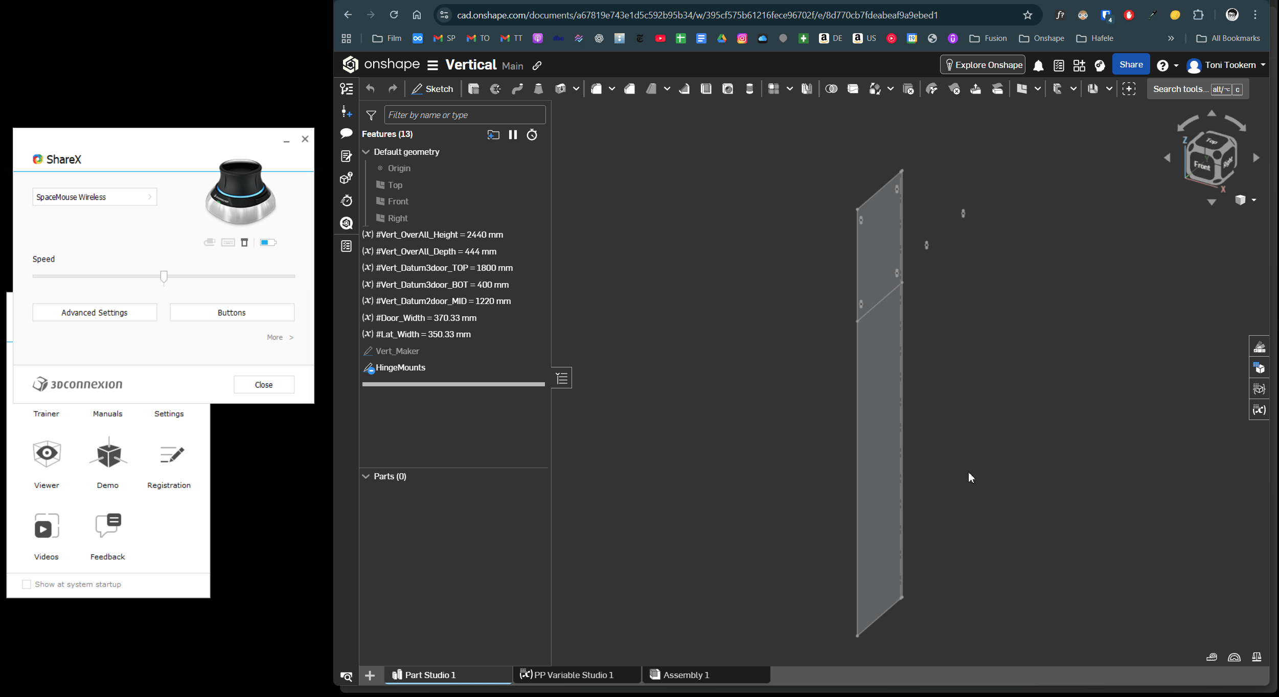

  • troy_ostrandertroy_ostrander Member Posts: 69 ✭✭

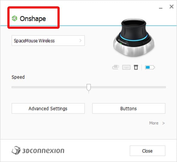

    Thanks for all the fixes but mine still doesn't work. I mean its connected but only rudimentary choppy zoom and 3dconnexion context hotkeys. I don't get orbit or pan and they are enabled in the 3dconnexion app. The 3dconnnexion app says chrome should it say Onshape because it looks like I am only getting basic browser controls. See attached gif. Any other ideas?
    UPDATE: It works now. 🤓
    1. Updated 3dconnexion to 10.9.9 and chrome to 143.0.7499.110.
    2. Restart computer.
    3. Made sure "Local network access" is enabled in chrome as @Andreas_Pedersen suggested.
    4. Refresh Onshape tab in browser
    5. 3dconnexion app should identify Onshape not chrome.
