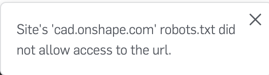

  • ron_deangelisron_deangelis Member Posts: 7
    Hi Matt,
    I added the horizontal constraint and fixed the rotation. Still getting not fully defined.
    Trying to add a link to the document, but getting this and not sure how to add the robots.txt .
  • Matt_ShieldsMatt_Shields Member, Onshape Employees Posts: 646 PRO
    edited May 24
    Edit sketch 4. Delete that huge rectangle above the model and your sketch will be fully constrained.
