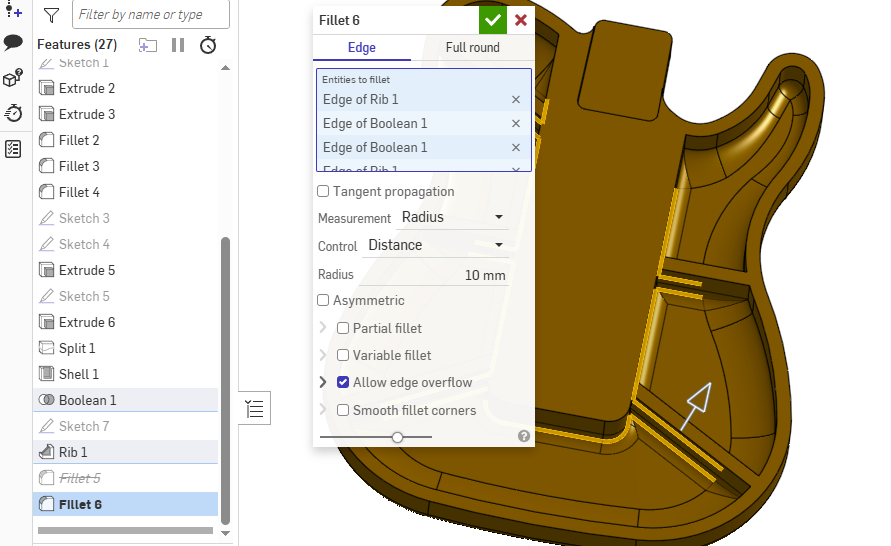

In this example, I'm trying to fillet the joint between ribs in a hollow, irregular shape.
The fillet in the left hand cavity works fine. The right one fails, even though it's a mirror image.
The only error I can find is "Fillet 6 did not regenerate properly: Adjoining edge not filleted."
The entire feature highlighted purple. Close examination reveals a gap showing the offending edge highlighted red. There is nothing telling me what is wrong with this edge.

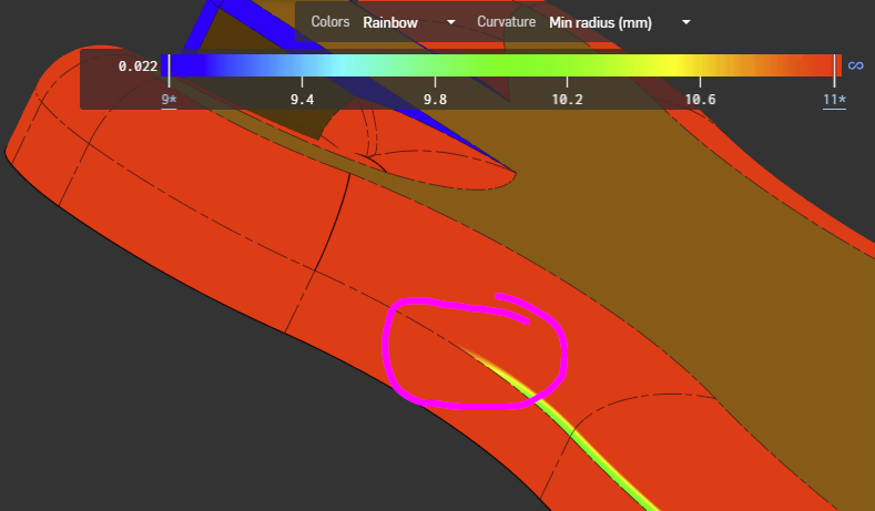

    Looks like your "fillet1" causes the shape to not be symmetric in the end.
    There's some weird condition after the shell where the edge transitions between tangent and not which causes some weird glitch in the surface:
    Curvature analysis can help if you know where to look, very small area on the inside:
    But the outside with limits set around your shell thickness (used 9-11mm here) shows how you might have some weird stuff on the inside:

    Turn off tangent selection. I did this fillet at a smaller radius and it failed. Then set to 10mm and selected edges individually to get a positive result. Tangent selection tries to select around existing fillet generated by shell operation.
    Fillet on edge of fillet doesn't seem to work so good.

    The curvature at the point circled in your 4th image changes due to the variable radii I've defined in fillet1. That is by design; this fillet is generally 20x40, but changes around the narrow part of the fingerboard cutaway. If I change the next point along (the 4th from the top of the list), to 20x40 the problem goes away… but that's an unacceptable compromise.
    But it does explain why those two pockets are not perfectly symmetrical.
    On a separate note, I can't really tell what part of the model your first three images are referring to.
    It looks like you've used a section view on your 2nd image, but I can't reproduce it.
    I also can't figure out how you got the view shown in your 3rd image. This seems to be a curvature color map… can you tell me the endpoints you used? is this a 'min radius' view?
    And of course, none of the above solves the problem, though it does help characterize it more thoroughly.
    Is there some way to precisely locate the discontinuity and "repair" it?

    First images are the inside area opposite the circled area on the outside. What I noticed was that the section that should have been straight was broken up into two segments so I zoomed in and did a section (along the right plane).
    The view is min radius with limits set to 9 and 11, i.e. either side of the thickness.
    One way to fix it is to delete the offending faces and patch with "fill". In this case it seems to be just the vertical face, just needs a new straight edge at the bottom (using a 3d fit spline) and it works:
