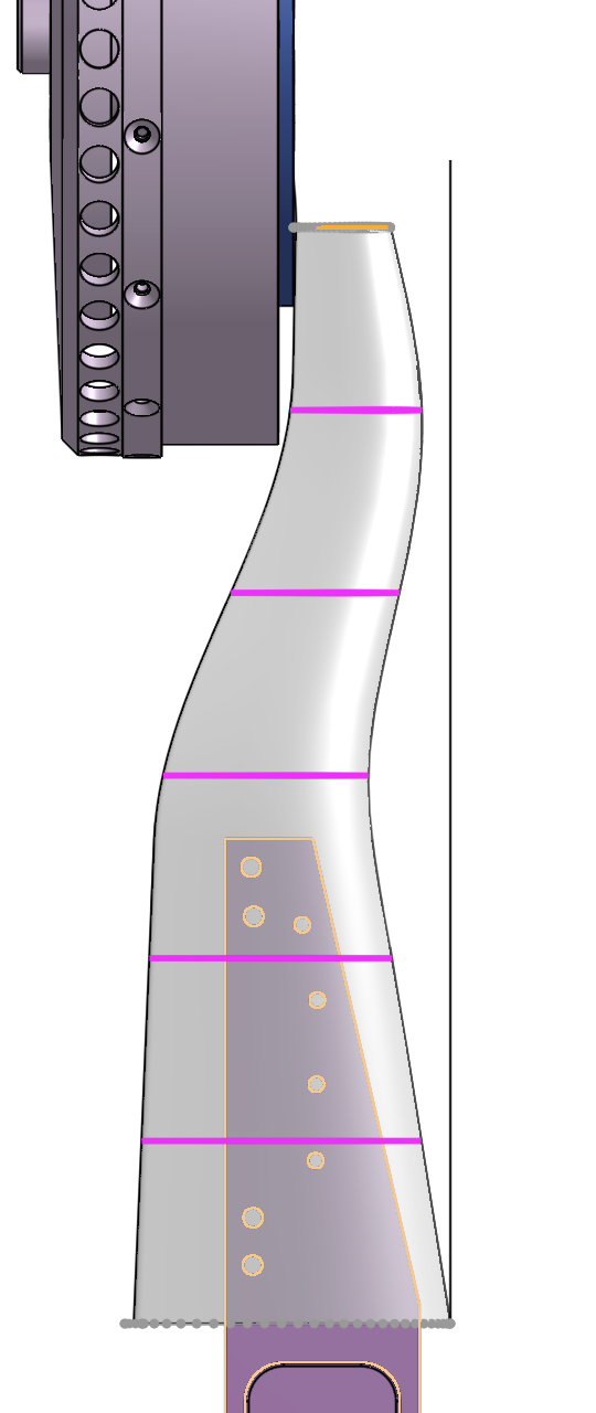

Sweep provides support for keeping a profile's orientation, and for aerodynamics reasons I would like to accomplish something similar with a loft.
Ideally, this motor mount would have every section aligned with the relative wind, which comes right to left. Whereas as OnShape does it, the profiles twist to basically be normal to the path at every point. This is good enough, but I'd like something better.
Is this doable?

  • MDesignMDesign Member Posts: 958 ✭✭✭
    Yes. although not like sweep. With loft you would have to build additional profiles to include in the loft feature

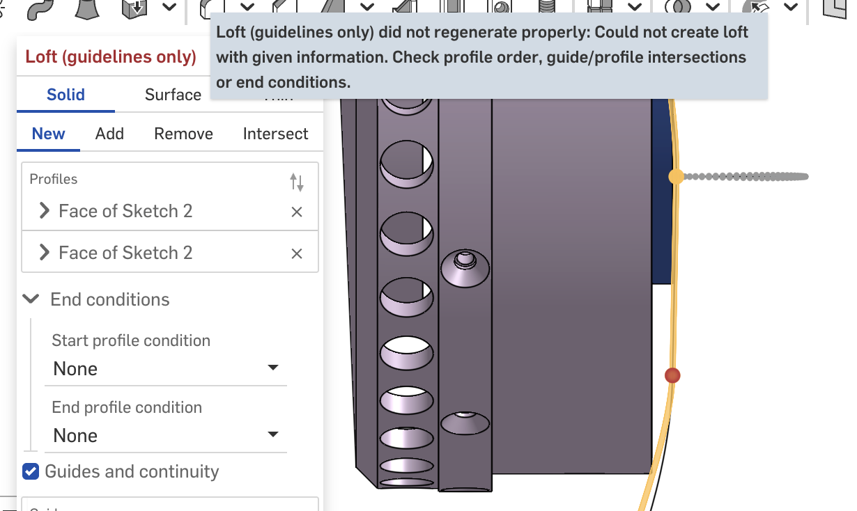

    I cannot get guidelines to work at all. If I have a straight-line path in addition to the guidelines I get "Failed to generate intermediate sections." and if I have just the guidelines I get "Could not create loft with given information".

    Guidelines must intersect sketches. The straight line does not intersect any profile sketches

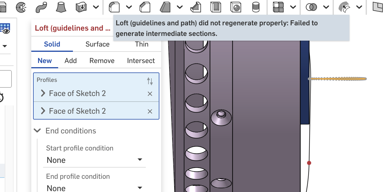

    Figured it out! @GregBrown was spot on to suggest using the Path as a tool, combined with Guidelines. The problem was a bit deep, but ultimately was due to where my path was only piecewise continuous.
    It actually took triangulating as while the system complained about the non-differentiable path with a red dot, the text error message did not give any specific information about that. In the below it mentions several things to check, none of which were the problem signaled in red.
    This is the error I get from the same loft, except with both guidelines and path configured. Note how it's even more cryptic.

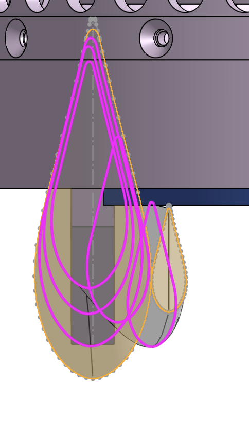

    Of course, once I fixed that, it worked. Here's the resulting pattern, which is perfect.
    Screenshot 2025-07-07 at 2.42.52 PM.png Screenshot 2025-07-07 at 2.50.42 PM.png
    P.S. @MDesign note that the straight line was a Path, and does not need to intersect all (or even any?) profiles.
