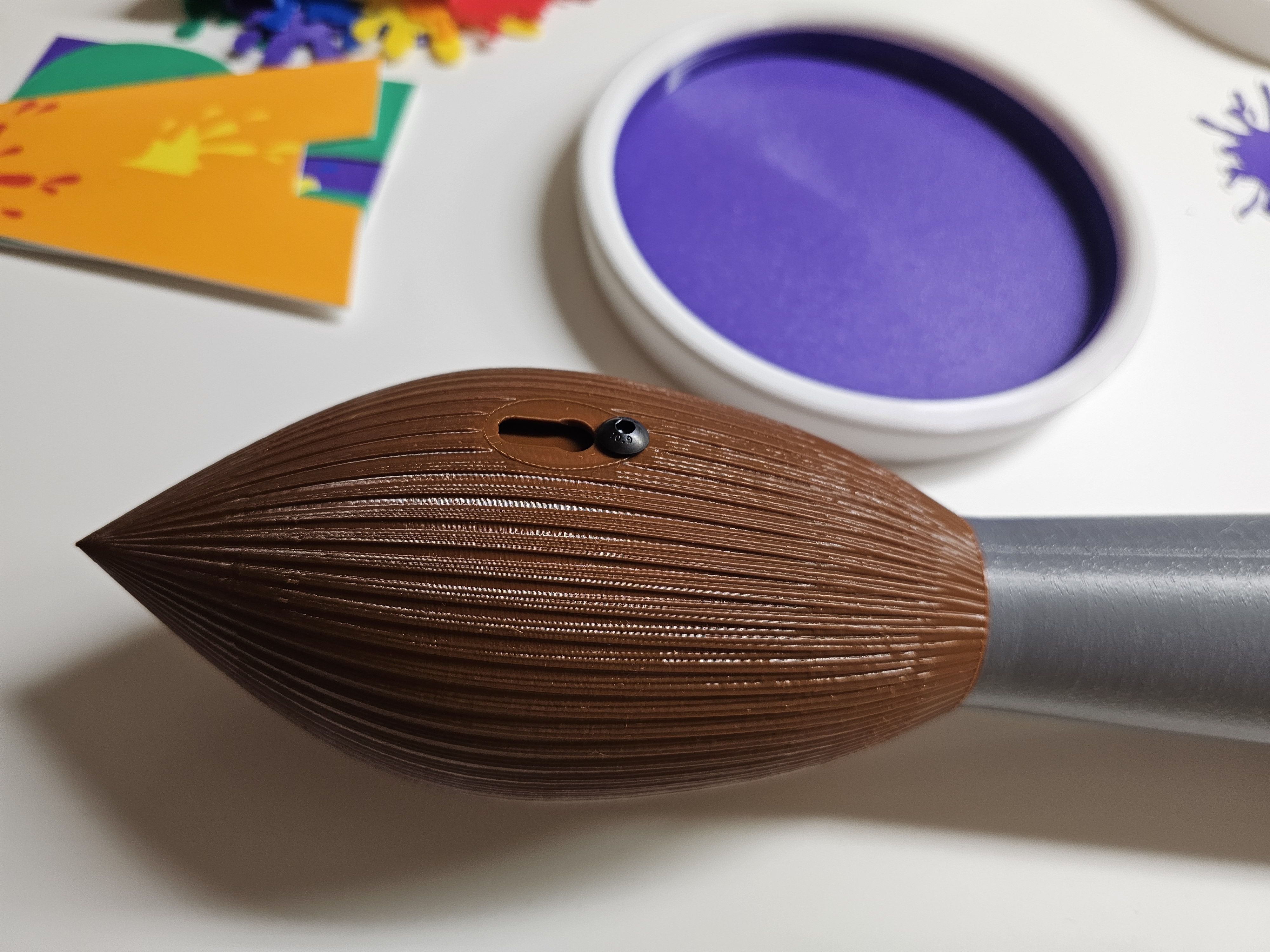

I'm working on a custom 3D model of a jumbo paintbrush for display, and I'm trying to add a hair-like texture to the bristles — something that looks like flowing or stylized etched strands.

What I'm Looking For is a way to engrave or emboss thin, flowing, hair-like curves onto a rounded/domed bristle shape, ideally with shallow depth and a sense of natural direction and taper.

You could try lofting each hair to an end point, kind of like with the Draw custom feature.
Essentially what it is doing is lofting a profile along a path to a point. So you could do a few bristles, then circular pattern to get the rest.
Another approach would be to revolve just 1/16 or so of the brush, then fillet the edges of that with a variable fillet. Then circular pattern that slice of the brush. This would give you a brush like texture.
RENDERCAD
Thank you @MichaelPascoe I managed to use your suggested tool to come up with something closer to what I needed. I will continue practicing with this tool to improve the bristle for future iterations of the product. Thank you again!
