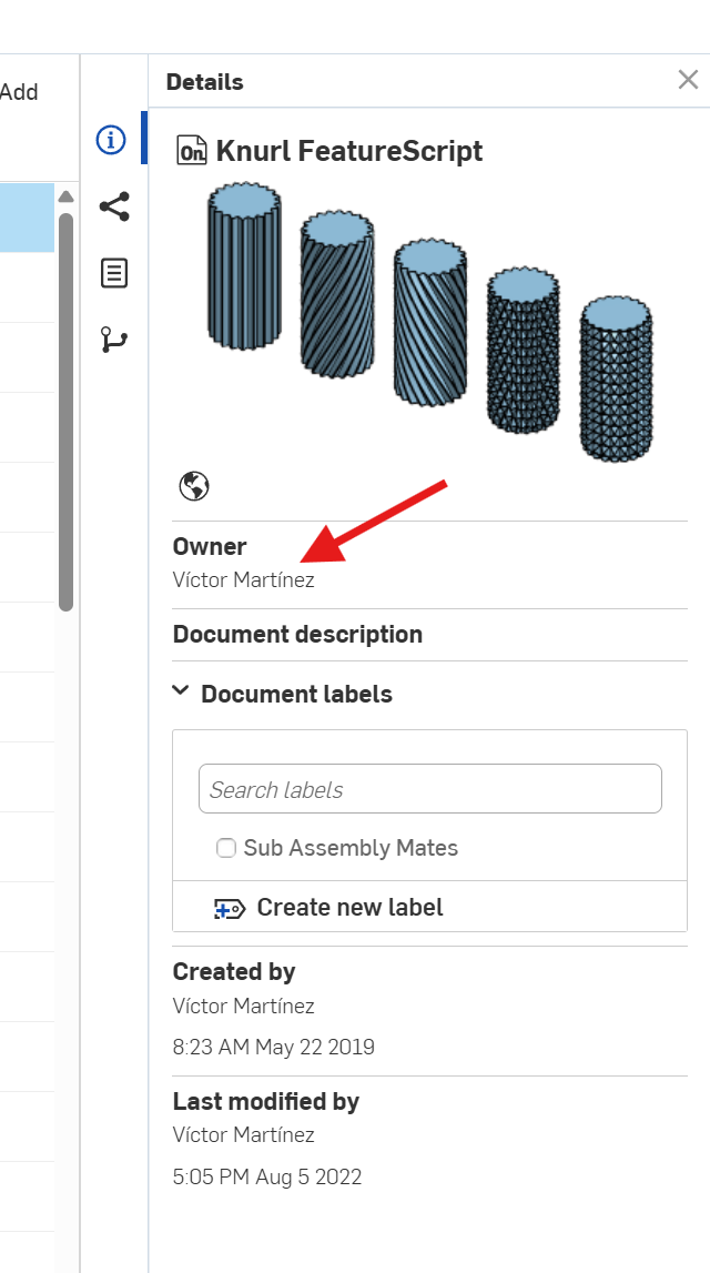

    One other trick you could do to find the author, is to open the original feature's document. Then go to your Onshape dashboard, and click the recently opened document. This will show you who created it. From there, you could hope that their name matches their forum username and try to send them a message…
  • rick_randallrick_randall Member Posts: 397 ✭✭✭
    Nice trick Michael, I've got to remember that one
  • kenn_sebesta167kenn_sebesta167 Member Posts: 101 ✭✭
    Fantastic trick, and I upvoted the feature request.
