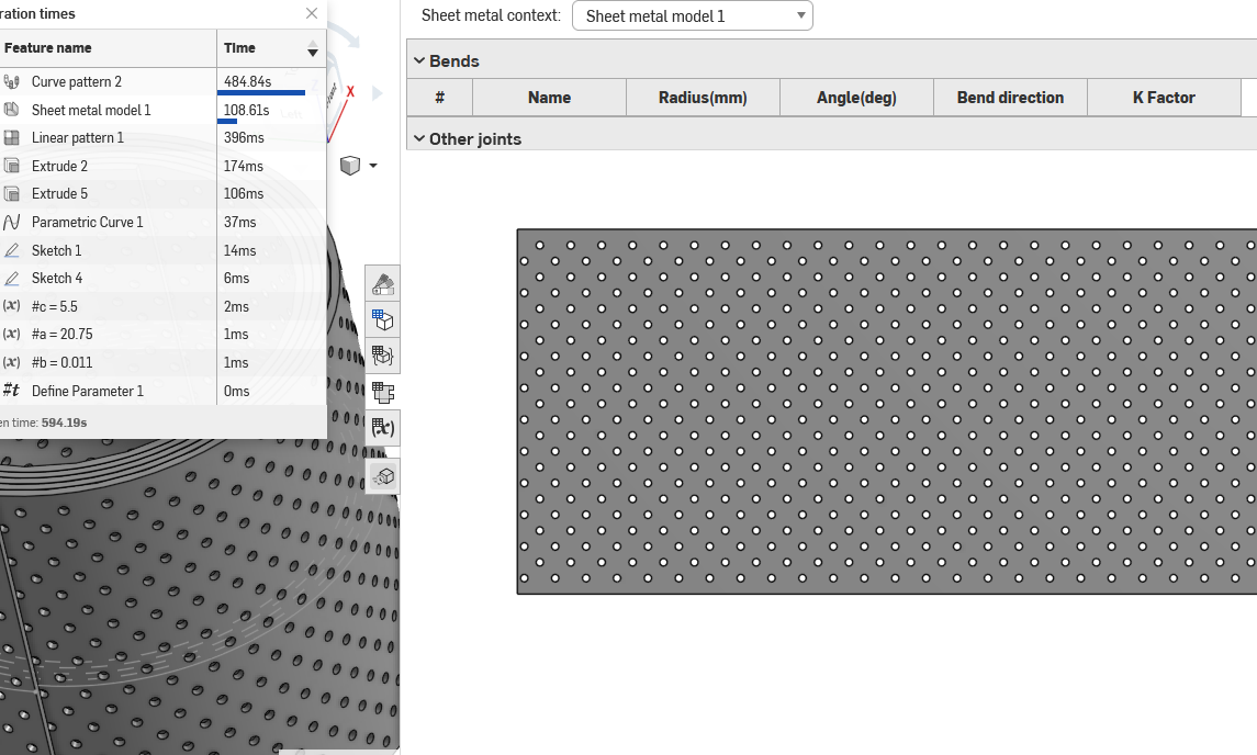

  • MDesignMDesign Member Posts: 998 ✭✭✭
    This has over 1150 holes so its not a compute problem. Essentially you create the whole thing as a solid without sheetmetal tools and then use the sheetmetal tool at the end to thicken just one face to your desired thickness. I tried doing the holes after converting to sheet metal but then it would be miserable trying to get the holes to line up once bent… which I assume not having them line up would negate the purpose of the holes anyway. but upon doing that I learned you could not pattern features in the flat pattern view. bummer. Disclaimer: I spent next to no time trying to replicate exact dimensions.
    In this case you will need to do the holes in flat pattern view, and utilize sketch patterns. It seems there's a limit of 100 for sketch patterns and I had to use 3 patterns to get enough holes. Problem is this creates a super long regen time as is the case with excessive sketch patterns. Flat pattern view won't let you feature pattern to take advantage of lower regen times. May be worth an improvement request if not already requested to support feature patterns in flat pattern view. I'm showing 216 sec to regen 1040 holes in a sketch. 😲

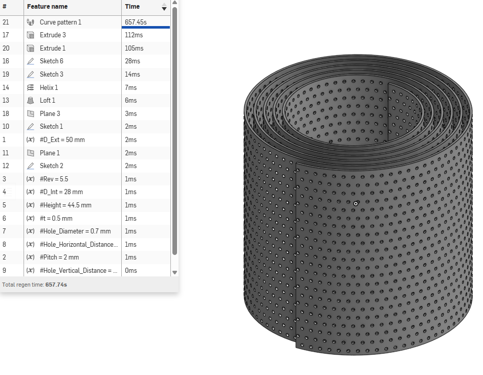

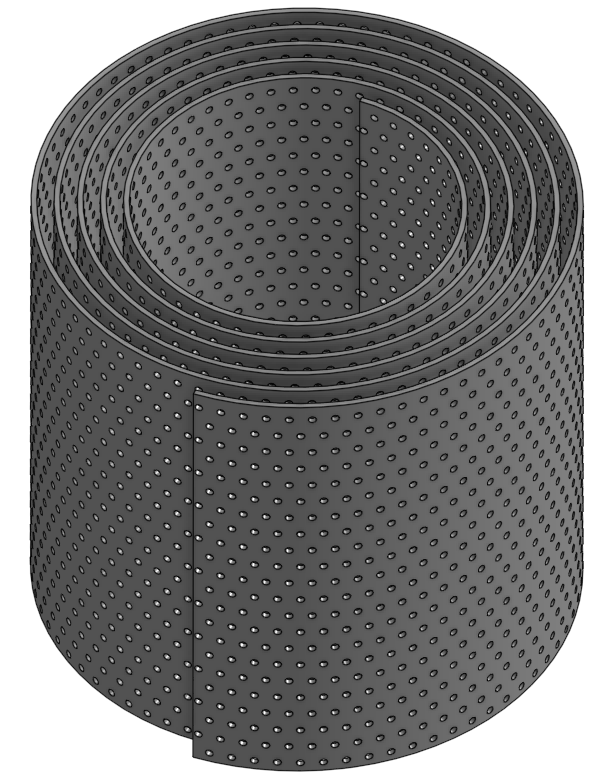

    After trying for days, I've come to the conclusion that nowadays it is impossible to do a SheetMetal model of what I have in mind. I tried doing the same to a solid instead of a SheetMetal and Onshape managed to not crash in the process, but still faced difficulties. This is an image of what I was attempting to do in the SheetMetal module, which I ended up creating as a solid part. Although similar to the responses of previous comentators you can appreciate that the number of holes is far greater than the other's, probably the reason why Onshape isn't happy with this geometry.

    I wouldn't say impossible. Just have to be patient for the brain to compute everything. 10min for a single part seems extreme and begs the question, Is there a reason you need to show every single hole vs just a sample of them?
  • albert_esteruelasalbert_esteruelas Member Posts: 8 PRO
    Yes, I need to simulate it, therefore it needs all the holes. It's just a shame how slow this piece is to draw. For the record, I attempted the same in other CAD software, and all of them failed trying it in their respective SheetMetal modules. In Onshape at least I could work around it and find an alternative. Anyway, thanks a lot!
    For anyone wondering, these are my build times:
