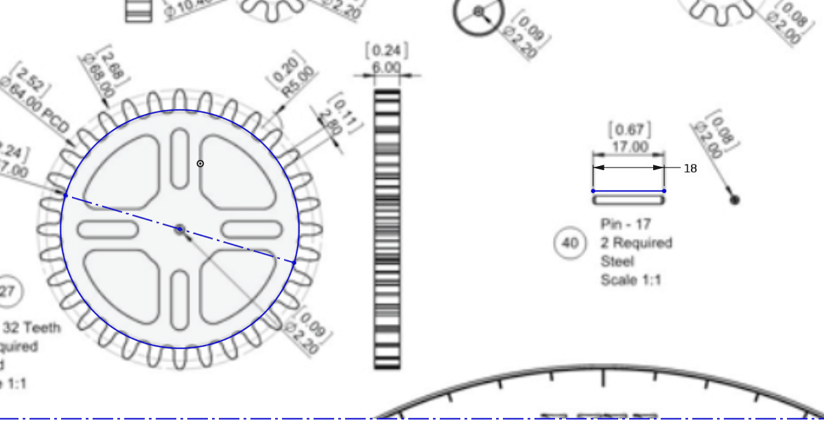

Hi,
I imported an image and found out that it is extremely easy to scale it to the correct dimension by placing a line over a line of known length in the image and entering the desired length and the image is scaled. I was very surprised at first.
Then I wanted to scale another image, but it doesn't work there: if a known line measures 26mm and I place a line of 26mm on it, the image is not scaled, but the line is drawn at 26mm and is either too short or too long and the dimensions of the image stay untouched.
What determines whether this method works or not?

  • MDesignMDesign Member Posts: 1,044 ✭✭✭✭
    This is a known pro tip not sure who gets the credit. but you can't have any other dimensions or contraints in the sketch. create a seperate sketch for each image you want to use.
    scaling image 8 in part studio 3 works fine like any other image. you missed the detail that there can be no other dimensions or constraints as there were 2 dimensions on the circle preventing scaling with the line..

    #MDesign:"…you missed the detail that there can be no other dimensions or constraints as there were 2 dimensions on the circle preventing scaling with the line.."
    Logically this can't work if you've already drawn a dimensioned line (I can't figure out if it makes a difference whether the length is displayed or not; I assume that the line has its defined length whether it is displayed or not, so the scaling should not work even without the length displayed, but this would be in contradiction with what you demonstrate in your illustration where there is already, apart the line by which you scale, a circle and a construction line, so I don't really understand it), but I initially only drew a line based on which I wanted to scale, but nothing else happened except that my line was longer than the one in the image, whose dimensions did not change.
    Logically 'no other' means nothing else besides that one dimension. Literally only one dimension can be present to get the scale to work.🤷‍♂️
  • ProApeProApe Member Posts: 180 ✭✭
    That's what I meant!
    So I don't understand why you can scale in your illustration even though there is already a circle and a construction line.
    because its not contrained to anything preventing it from scaling with the rest of the geometry
