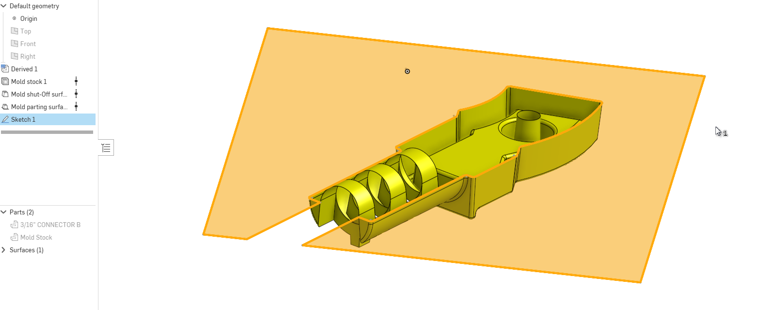

Folks, Sorry for this incredibly basic question but I can't figure out why this is hard for me. I want to create a very simple planar surface using the boundary shown by the sketch below. (and then knit it to the golden colored surface you're seeing.
But I can't find the command that creates a face or surface from a sketch. What am I missing???

  • GregBrownGregBrown Member, Onshape Employees, csevp, pcbaevp Posts: 370 image
    Offset face with zero offset distance.
  • MDesignMDesign Member Posts: 1,281 PRO
    Extrude using the surface option?
  • dave_franchinodave_franchino Member Posts: 78 ✭✭
    @GregBrown - OK I'm amazed that's the work around. Don't know why there isn't a planar face option. I don't think I ever would have found that. Thanks!
  • eric_pestyeric_pesty Member, pcbaevp Posts: 2,501 PRO
    Also, depending what you need to do with the surface, the sketch region can often be used directly (i.e. it already is a surface) so might not even need to create an actual surface…
