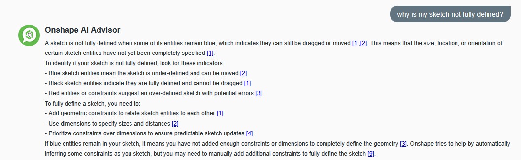

    For the life of me I cannot even replicate the example given by @paul_chastell above, is there a video link somewhere that will get me through this?

    @MDesign Thank you again for helping. For whatever reason this is just not going in. I don't remember this error message previously using Onshape, is it new?
    For the very very simple shapes i use to make stuff with my 3D printer, I've had success before so will continue as was, and ignore the messages.
    I'll keep checking for a video as they explain more than words alone i find.

    @michael_fitzpatrick053 If you don't know the meaning of parametric, its going to be very difficult for others to help if you don't have a base level skillset and vocabulary. As kees said the tutorials are worth the time if your going to use the software regularly. And after reading your last replies, I think the answer to your question is not fully defined is simply a status of the sketch, it doesn't mean you can't continue designing. 9 times out of 10 new users haven't located the sketch with respect to something higher up the feature tree. this will flag the warning every time.

    Wait, does it mean this is somewhat recent feature??? Like before there was no way of knowing if everything is constrained or not???
  • _anton_anton Member, Onshape Employees Posts: 478
  • jack_chen386jack_chen386 Member Posts: 2
    Yes
