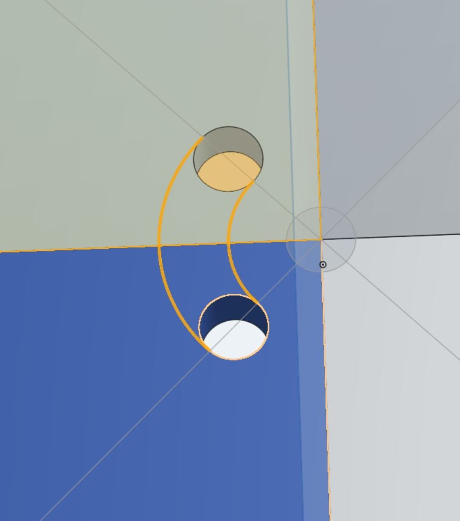

I am trying to create a stencil for a wifi symbol (dot in the centre, 1/4 radius lines emanating out) sort of "( ( . ) )" (not to scale). How do I combine the shapes I have drafted below into one, to then extrude remove the ? The terms to search elude me.

    I can select either adjoining line (see attached) but the system does not recognise them as a shape but 2 lines. There has got to be a command to "morph" these 4 items (2 circles, 2 arcs) into a single shape which can then be extruded?

  • spencer_arnoldspencer_arnold Member Posts: 8

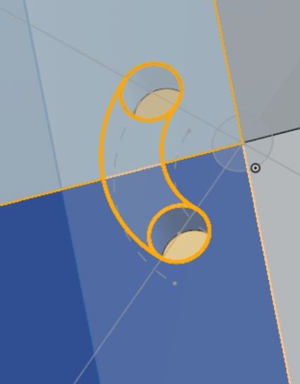

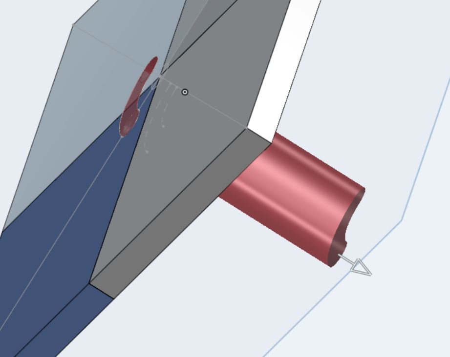

    OK can select all 4 components into one new sketch with the "Use" button, which shows as first picture. When I try to extrude, it highlights the extrusion as red. (attached 2). It took ticking the option of "Merge all" when selecting the extrude of the sketch to achieve the desired result. thanks all for the steer.
