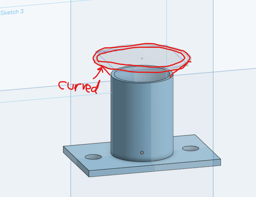

I am having some trouble to create a curved funnel. In order to connect two cylinders.
I can't get the design process straight in my head. I tried to use the revolve function and revolve a curved shape around the z-axis. but i am not able to draw the correct shape on the existing lower cylinder.
I also tried the loft function (with two circles on an offset plane obove the lower cylinder), but it gave me never a valid result back.
Any hint on how to fulfill this task in general, and what would be the right approach in this case is highly appreciated.

    Hey Roman. Please post a link to your document that includes the sketch you were not able to draw correctly. A revolve should work. I assume the cylinder is a loft. Another method would be to sketch a profile of the cylinder and the funnel and revolve them together. - Scotty

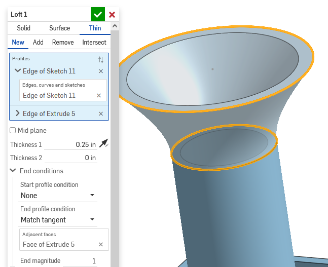

    Here's one way to do it. thin Loft with end conditions. Alternative to the usual revolve suggestions.

    Thanks Scotty! I tried sketching the profie, and that worked fine…

    I also tried the Loft function. I was missing the end conditions. Thanks a lot for the hint!
