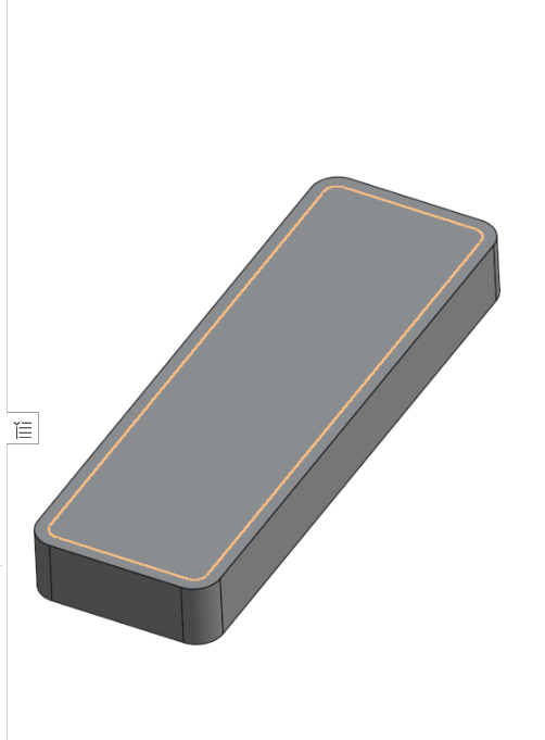

How to add a 1 mm deep slot in this inside offset around the whole piece
Hello from Spain. Very much a beginner with Oshape and CAD.
I need to add a round slot 1 mm deep/ 1 mm wide, around the whole perimeter of this piece (on the yellow line).
I've tried drawing the offset line inwards, and then apply SLOT, but I can't get it to work properly!
Thank you!

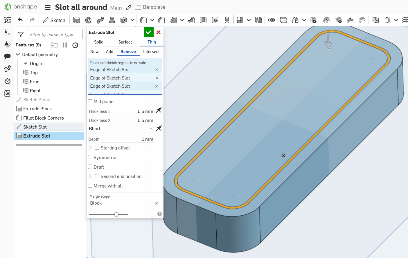

Extrude into the material with the options "thin" and "remove" with a value of 1mm each.
https://cad.onshape.com/documents/3099b7259329311a88f70c44/w/e5f115cbd0ccd5cb408f388b/e/f9416f1387db74862297de66?renderMode=0&uiState=68aaf22ef8e87e44d29a1586
@martin_kopplow what's the advantage using thin here and not just a solid remove? I don't really use thin. Maybe I should?
It's one border line to draw in the sketch instead of 2. Easier to sketch and dimension, and more robust with changes.
I believe the op is asking for a cut that follows the perimeter and not a full area extrude. You should use thin more often, might save some sketch time.

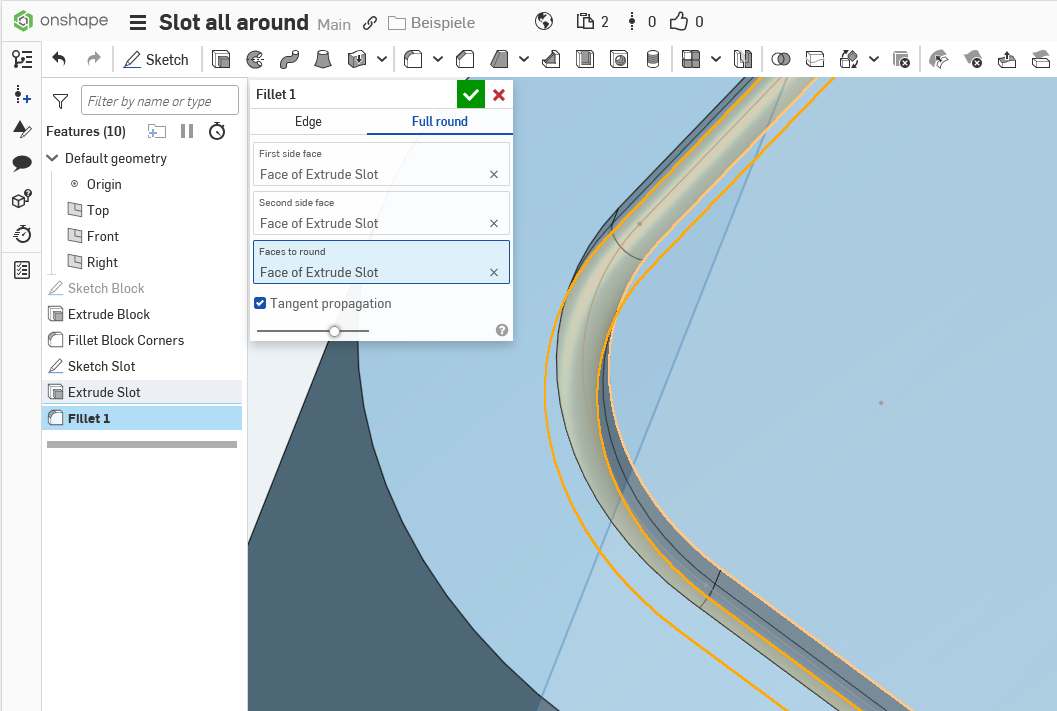

@pedro_carrizo I believe you mentioned a rounded slot so you'd have to build on martin's suggestion with a full round fillet to get the bottom of the slot rounded. You can also get there with a sweep profile and your path.
OMG! Thank you so much. That worked perfectly. I appreciate the time you took to model the piece so I could see all the steps.

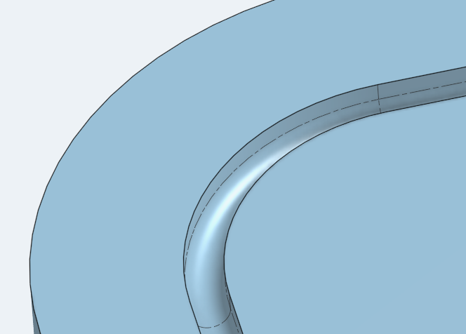

Since we're at it… is it possible to make the lower part of the extrusion round with the same radius as the width? I need to put a round rubber gasket inside. It's not that important in this case, but it would be nice to learn how to do it.

@pedro_arrizo, yes it is possible with an extra step. Use the fillet tool with the "full round" option, select first vertical face, second vertical face and the ground of the groove in the tool dialog:
https://cad.onshape.com/documents/3099b7259329311a88f70c44/w/e5f115cbd0ccd5cb408f388b/e/f9416f1387db74862297de66?renderMode=0&uiState=68ac19a4ba80c0467b0c2571
Though, as Nick already pointed out: It is good practise to put an O-ring into a flat slot. Make the slot slightly less deep than the chord strength of the gasket, say 10 to 20%, and when assembling, the gasket will get pushed into the groove, expanding a bit to either side and providing a good seal.
