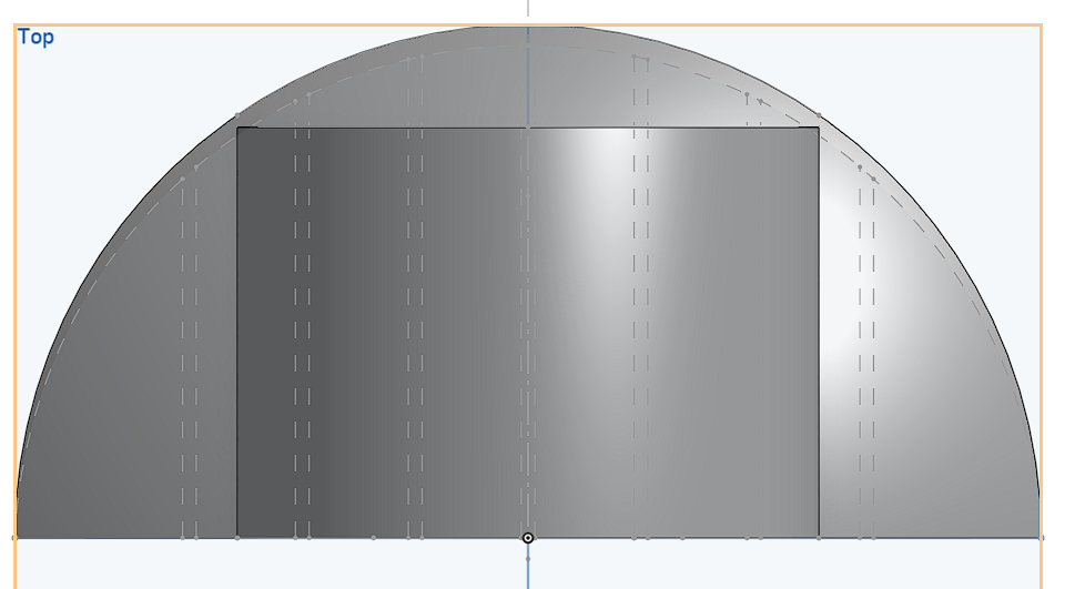

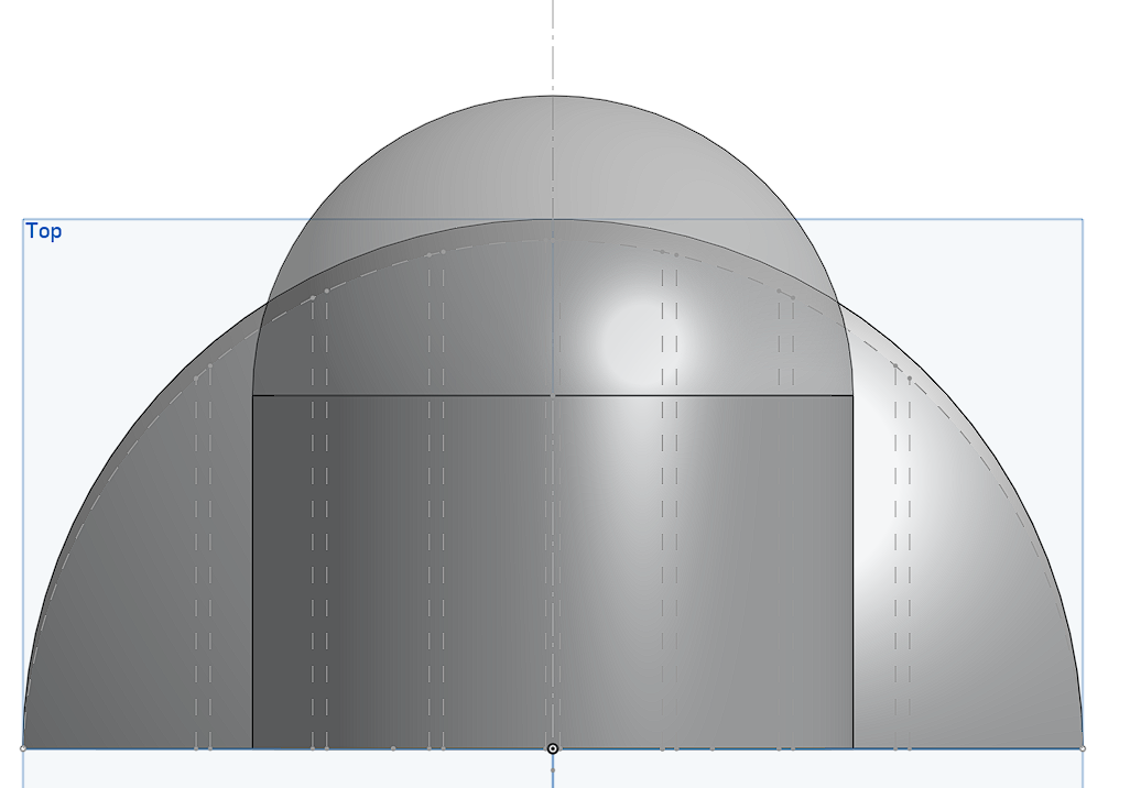

I have a part that I need to put an end cap on. The face is round but the "revolve" is not the same radius.
What is the best way to achieve this. I want the end cap to follow the same line as the part below but maintain the 3mm wall thickness throughout.
TIA
  • David_YL_NguyenDavid_YL_Nguyen Member, Onshape Employees Posts: 182 image
    Hey @adrian_blood,
    It's not so clear to me what you are trying to achieve here, could you share your public document so people can have a look?
    Maybe, you can just design your part as a solid body and then use the shell feature with 3mm wall thickness, is that what you need? Cheers
  • martin_kopplowmartin_kopplow Member Posts: 1,300 PRO
    You can't revolve if the radius isn't constant. Try sweeping. Apply the wall thickness after this operation, that'll save you a lot of work.

    This is a top down look. I want the smaller sphere to have the same arc as the larger sphere.

    https://cad.onshape.com/documents/64a83e5797a62734248374c2/w/0225f8b57efbdb21c0d8bf7f/e/c3b1aaf95be86c2d632fe7cf?renderMode=0&uiState=68ad586d89d92433a8b9a6e9
    I am trying to have the endcap follow the same profile as the arc below it.
