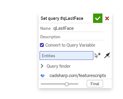

How to use the Query Finder:
(Step 1) Use the
Set query attribute feature to make a selection that you want to save for later.
This will create a variable with the name of your attribute which you can use downstream.
Note: Query Finder doesn't require you to set an attribute, you can change the QF search type to the following types of searches.
Supported search types include:
Everything: Searches the entire part studio.Attribute: Searches only entities with the specified attribute attached to them. Easily set with the Set query attribute feature.Feature: Searches selected features in the tree for specified entities.Property: Searches only entities with the specified property and property value.Identity: Searches entities that have had their identity set.Transient ID: Searches for a specific transient id.
(Step 2) Click on the Query Finder button to enable the query finder.
(Step 3) Input the selection variable that you created earlier in the tree. You could also type this attribute name manually like this: "toColor"

Query Finder (Update!)
The following features have been updated with this latest query finder functionality:

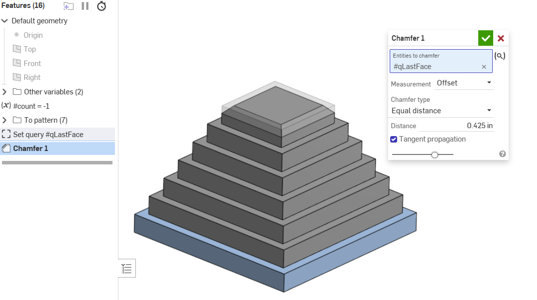

🎉 We can now use Query Variables - (Onshape Update) supported by Onshape's default features!
Welp, the query finder had a good 2 month life span. lol
Deprecated? I haven't played with the new query variables enough to tell, but at a glance I think I can deprecate the query finder.
Learn more about the Gospel of Christ ( Here )
CADSharp - We make custom features and integrated Onshape apps!  Learn How to FeatureScript Here 🔴
Query Finder isn't deprecated quite yet. The new Query Variable doesn't allow expressions or support feature patterns.
This will allow you to still use expressions and feature patterns using the query attributes, but then if you want you can convert the query to Onshape's new Query Variable for use with default features. A few extra clicks but it is nice to have the option.
