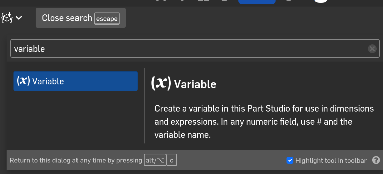

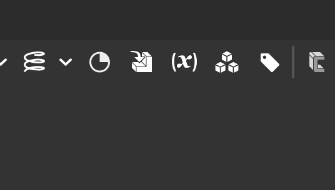

I'd love to use the "query variable" feature in a current project, but I don't see the button. I've confirmed the version number is 1.203. I do, however, see the button in new documents.

    For a kick start of the update version of a document is to send the document to trash then restore from trash. The next time the document is opened a query will ask about scheduling an update. Your answer will be 'now'. You will have to wait while the update is done.
  • eric_pestyeric_pesty Member Posts: 2,312 PRO
    You don't need to do this anymore… You can go in the hamburger menu an select "updated workspace" now!
