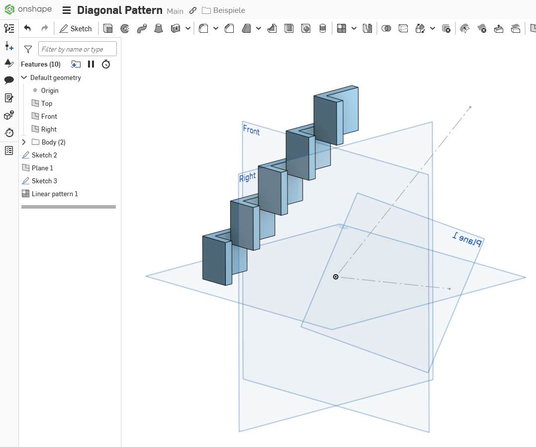

    A diagonal is always a straight line, so there can be a plane coincident with the line. Just create the plane, sketch out the line on it and then use that. There might be other approaches, depending on what you want.
    https://cad.onshape.com/documents/f080bd4c9f812dc5ddd91d04/w/46c90088202f081c9b3818c5/e/36d955e081b899f914d1dbf9?renderMode=0&uiState=68b5a921014e370ee81219cd

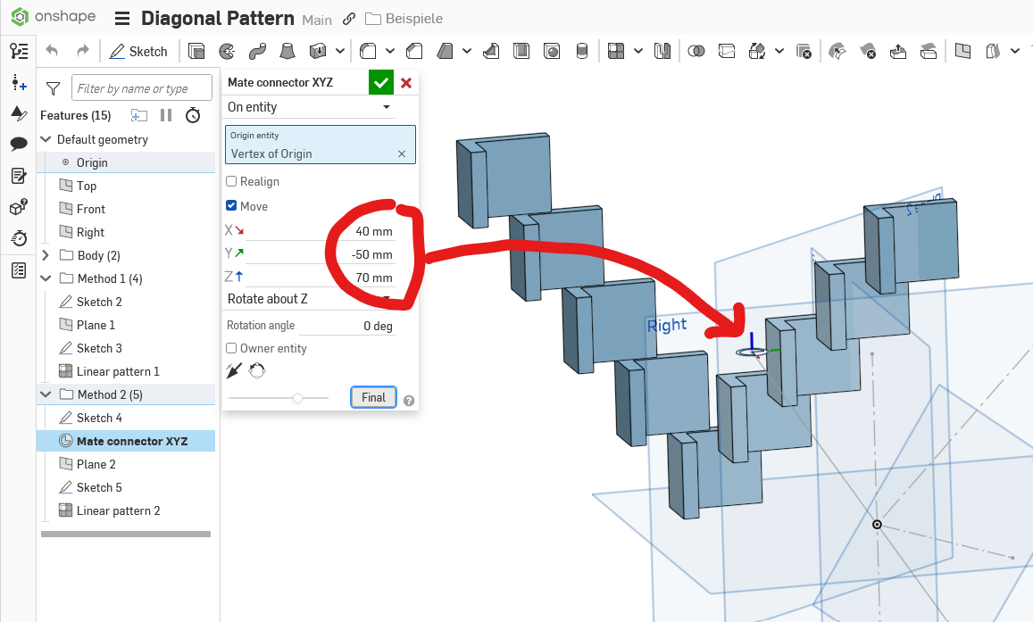

    In this case it is two angles that control the direction. You could also create a Mate Connector in a XYZ location, then make the line beween origin and the MC to use as the direction.
    Then, the coordinates in the MC edit box control the direction.
