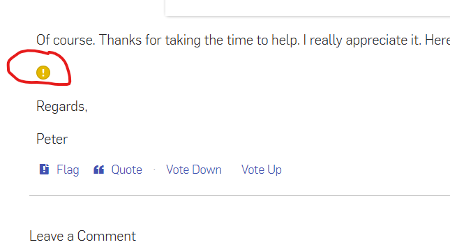

  • glen_dewsburyglen_dewsbury Member Posts: 1,145 PRO
    Looks like you need to wait for the spinning wheel to stop before hitting enter. I've run into this myself.
  • peter_robinson449peter_robinson449 Member Posts: 9
    Oh, Thanks for letting me know. Let's try again.
