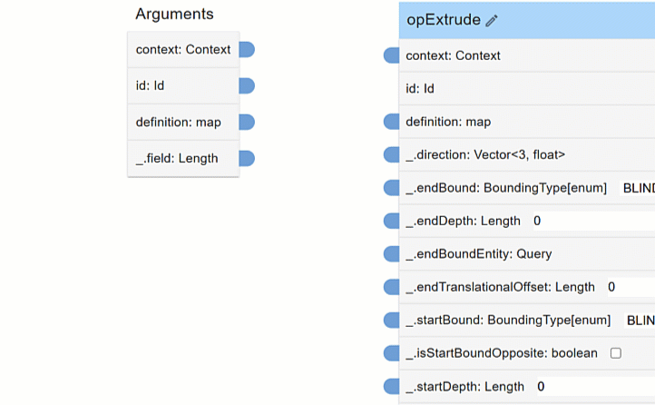

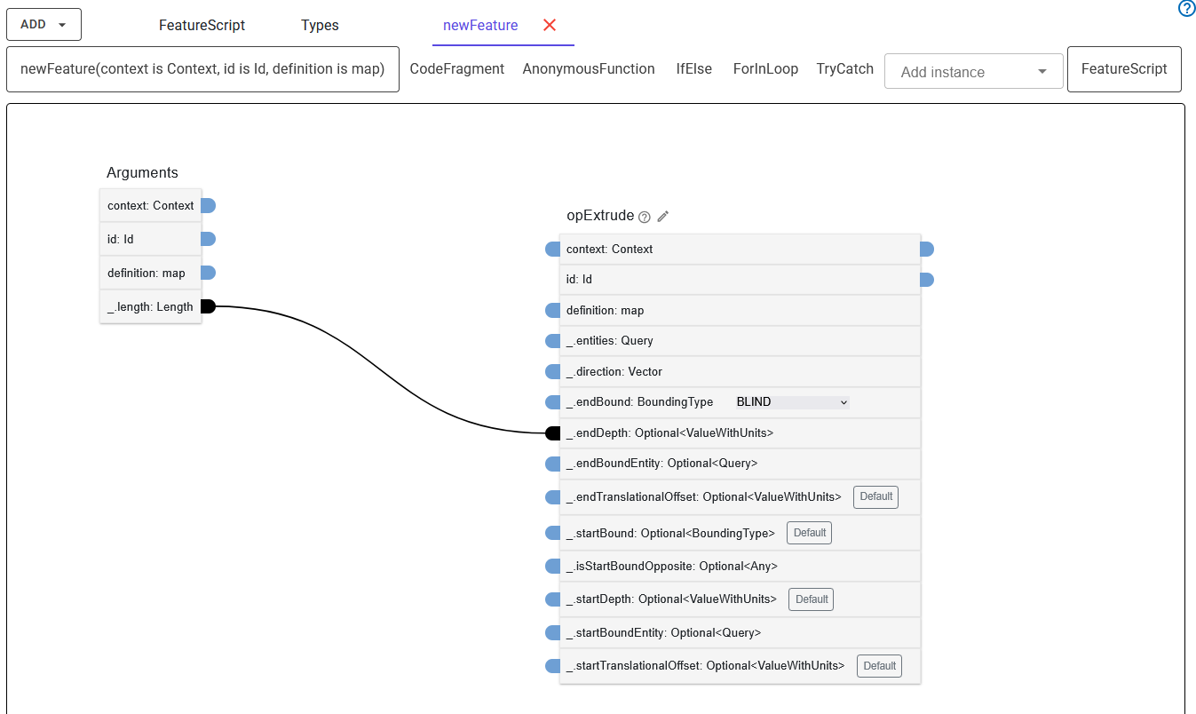

Today within the set of other free Onshape automation tools by CadSharp we releasing in Onshape Appstore the beta version of unique tool for visual and interactive creation of Onshape's Custom features code - FS Node Studio.
It aims to abstracts away the most cryptic parts of Featurescript functions - the id's manipulation, and represents each function instance - the building block of your custom feature - as a diagram node with inputs, outputs and the links connecting outputs/results of functions with inputs of other descendant functions.
It has a special grouping constructs to represent well known code statements like if-else, try-catch, for loop, and embedable raw code fragment. It enforces type safety of passed values by checking type matching of source values and consumer argument type, so type annotations are your friends not just at runtime 😏 (but not be afraid, the unchecable Any parameter type will let you bypass type checks as we used to) . The tool has full publicly documented Onshape standard library set of functions and types.
The tool is capable to generate full FeatureStudio declaration code including custom types, enums, top level functions and custom features, except the import statements and FeatureScript version directive.
Also the current limitation is that you will not be able to save you diagram within Onshape tab and you will need to manually copy code from featurescript output of the app to FeatureStudio tab.

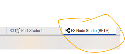

    @S1mon You can open FS Node Studio (BETA) from the app menu (Bottom left +) then when finished copy your code over to a Feature Studio. However, currently it is not saving the data anywhere. So if you close your browser tab and open it again, your data will not be saved unless you have copied it over to a Feature Studio.

    I mean the tab within onshape document, the own app tabs will persist while the user session is retained, but if you close it or refresh - it will not be saved.

    Soon to be deployed feature of Node studio - auto-mapping of array outputs. If the output of the node has an array term the special array item out term will be created as well. The consumers of that term will be submerged into for loop, iterating through the items of the source array. This abstracts away one of the annoying parts of the workflows when user has to loop through the collections of items.
    Few special rules regarding this feature:
    map source term → normal target term ⇒ target instance get captured by for loop
    map source term → instance inside loop ⇒ array item get accessed using existing loop iterator
    source term of mapped instance → instance of array input term in the outer scope of the loop ⇒ special output from inside the loop will be generated
    source term of id type of mapped instance → consumer instance in the outer scope of the loop ⇒ special id output will be generated using ANY_ID template
