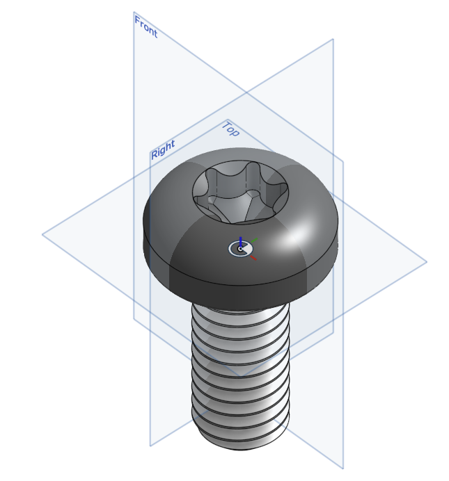

    Related to this, is there any good convention for which way fasteners should be modeled in Onshape relative to the default planes? I prefer to always have the origin and the mate connector that I'd call "Near" be the same location, but what about the direction? Is "top" the plane that corresponds to the mating part?
