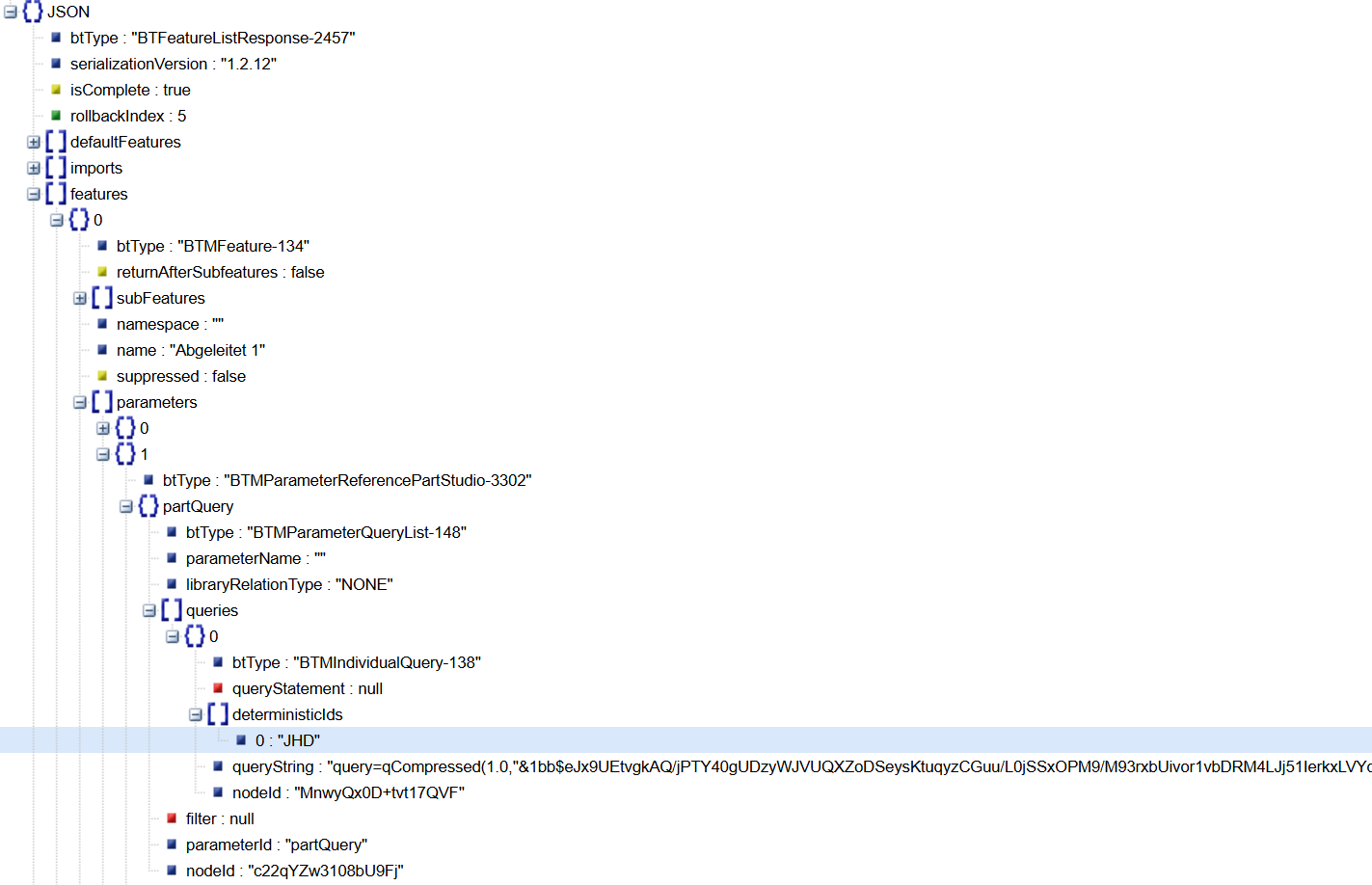

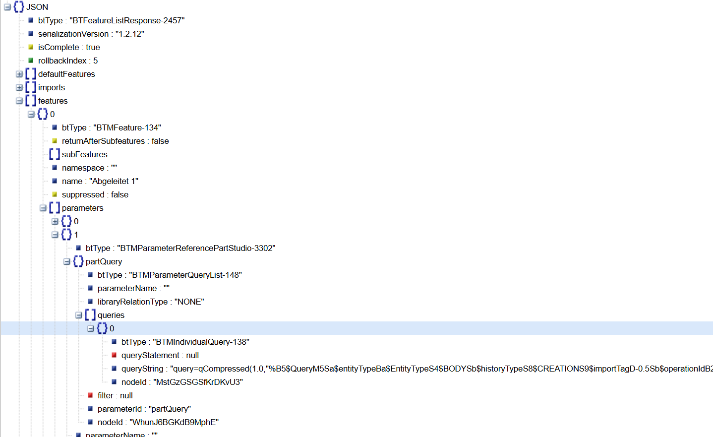

  • FladdieFladdie Member Posts: 14
    Follow-up / Additional question:
    In some cases, inside the partQuery → queries section, I can see a field called deterministicIds that gives me the short Part ID (e.g. JHD). But in other cases (other part studios), with the exact same API call, the field is missing. Instead, I only get the queryString.
    I’ve attached screenshots here showing the difference:
    • Screenshot 1: no deterministicIds field present
    • Screenshot 2: deterministicIds is present with the expected Part ID
    👉 My question: Why does deterministicIds appear sometimes, but not always?
    Is this related to how the derive selection was created (e.g., “All bodies” vs. explicit part selection), or whether the source Part Studio is referenced from a workspace vs. a version/microversion?
    Any guidance on how to consistently obtain the Part ID from the API would be much appreciated.
    @Caden_Armstrong you just saved my day (and my weekend) — thank you! I totally didn’t think to try the v1 vs v12 endpoints. Switching to /api/v1/partstudios/.../features gives me the geometryIds exactly as you showed; /api/v12/... returns the compressed query.
