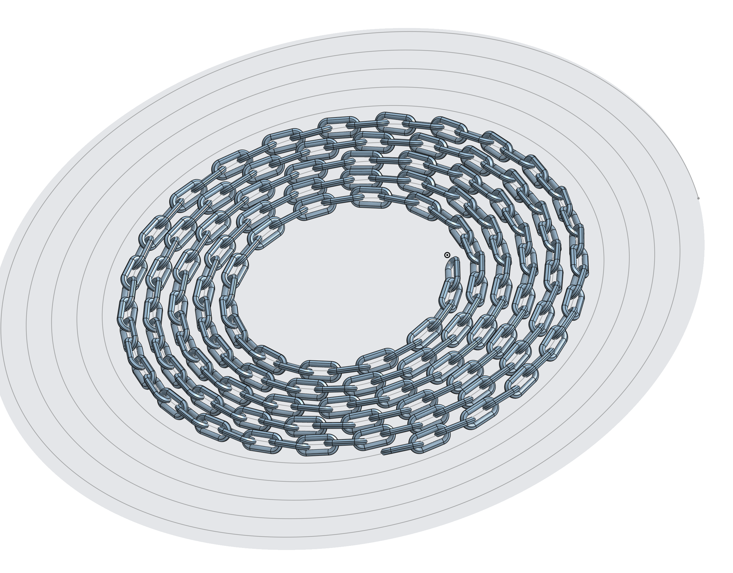

I would like to print a chain in spiral on my 3D printer. I have been able to make th chain link but when i try to make a pilote repetition for more link, as the spiral gets bigger, the chain links start touching each other and that will be a problem whe printing and getting the chain off the printhing bed. Whould there be a solution so that the spacing and the angle between each link follow the spiral eaven if the spiral get's bigger or smaller or if i change the number of links in the chain. I hope that my explanation of the situation are good. Here the link to the onshape file. There was an error displaying this embed.
  • marc_andré_mercier804marc_andré_mercier804 Member Posts: 4
    Image of the spiral

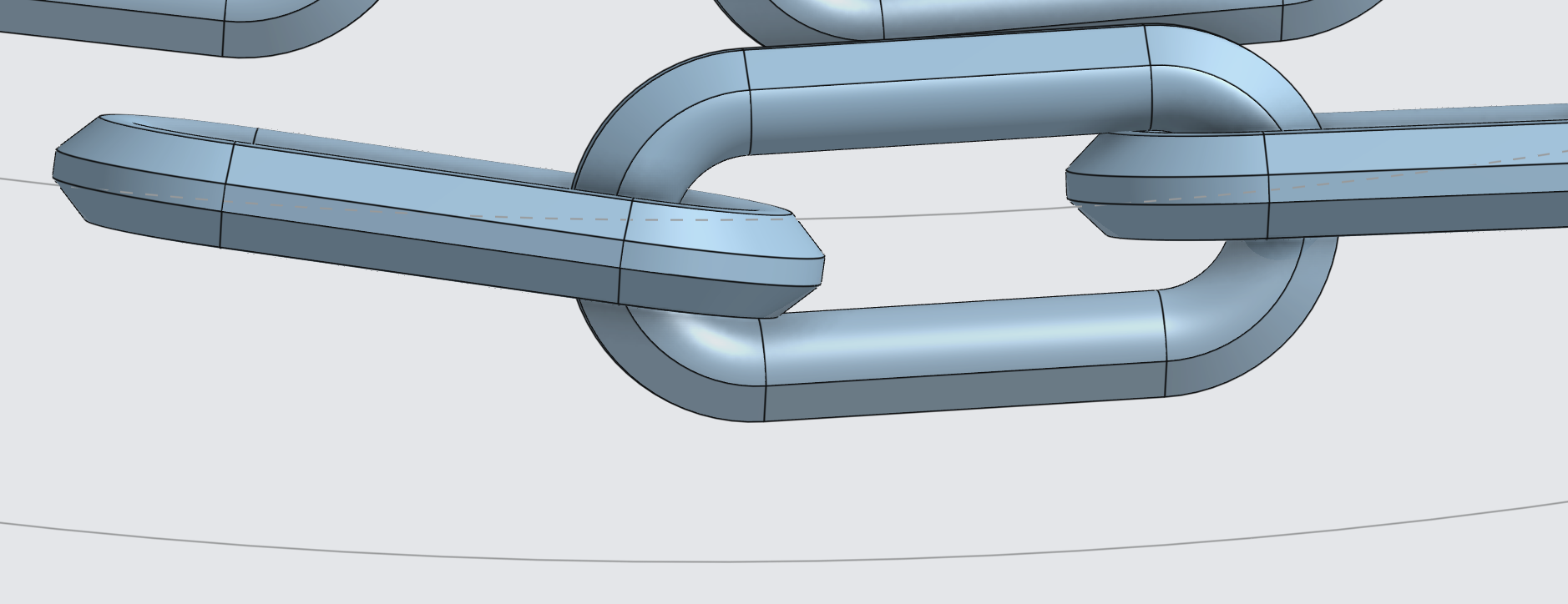

    Beginning af the chain

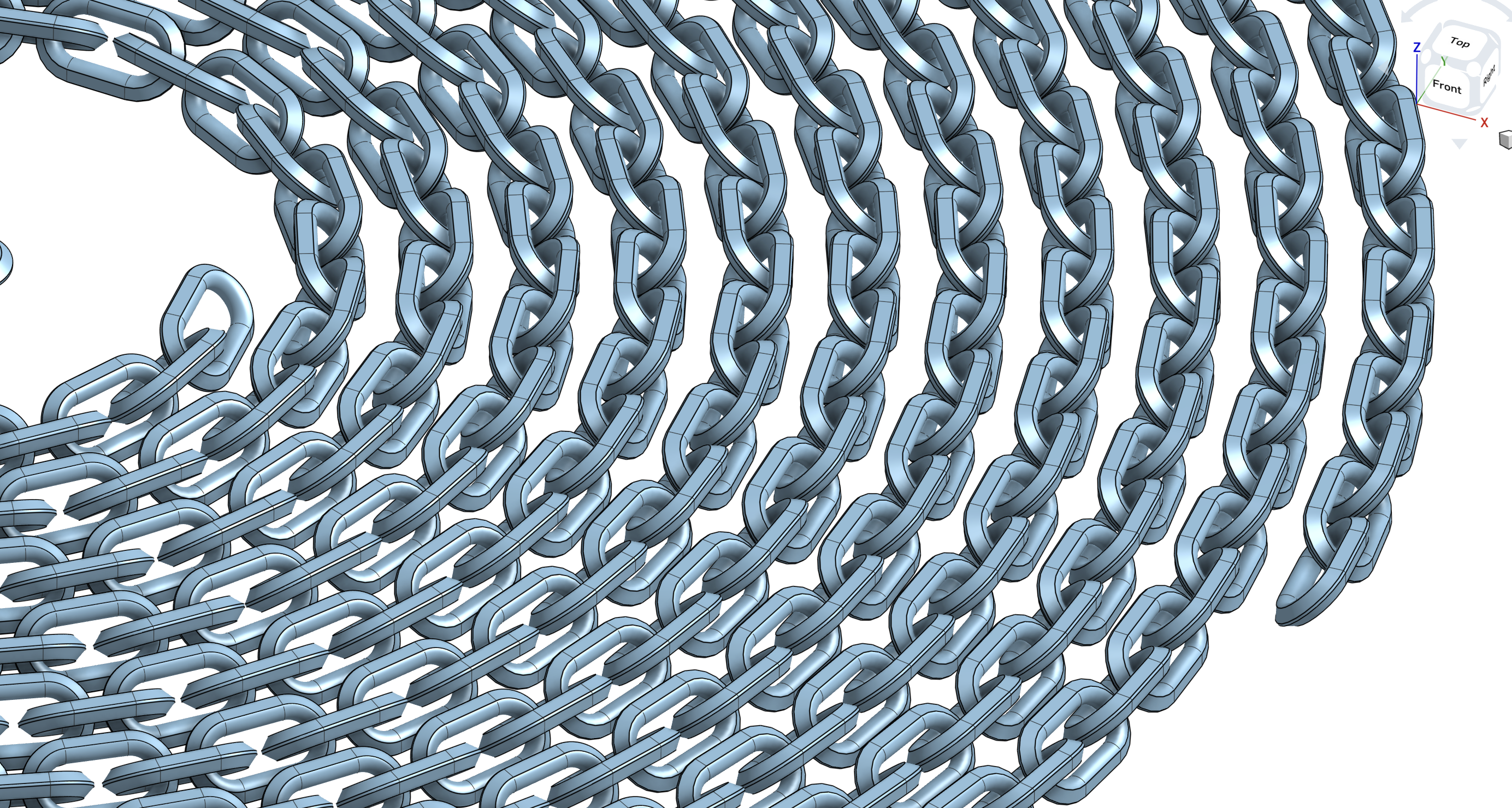

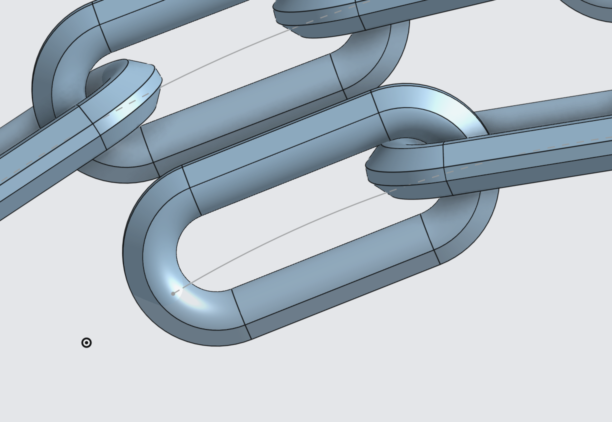

    End of the chain two links are touching and if i add more links, they touch even more.

    Tricky challenge! First, I don't really know why the Curve Pattern feature doesn't keep that alignment. It seems like it ought to. I did my own test and found the same thing.

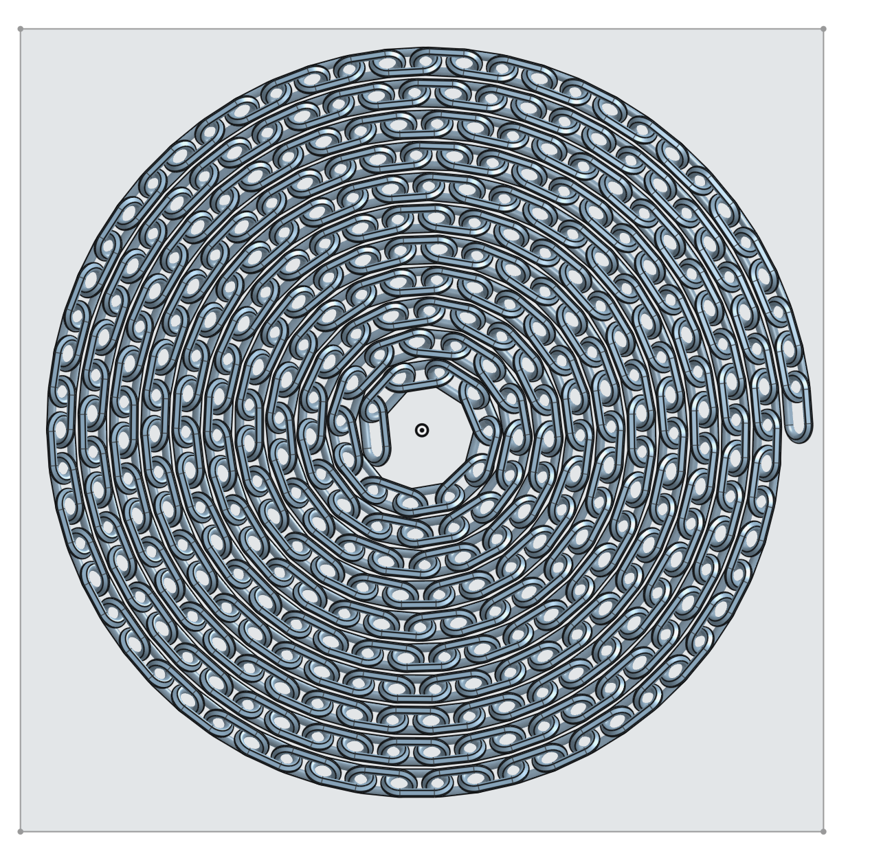

    Next I tried a feature pattern using my 3D Points custom feature that can create mate connectors on curves, and that result looks like I'd want. The last links don't end up skewed. Lot's more math required for this approach than feels like should be needed though.
    btw, I think you can push your links a bit closer together to fit a lot more on the plate!

    I did some testing as well. and found that (assuming your patterning 2 links) that if you place your center of your links at the end of the spiral the angle is maintained toward the center. I dunno why, Just what I observed.

    If you're trying to maximize the number of links in one layer on the print bed, then doing a pattern that goes back and forth in rows would be better than a spiral. I have no idea what the mathematically optimal packing would be, but spiral is not it.
