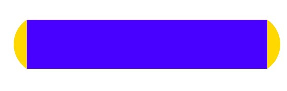

Hey there,
I'm new to CAD, new to Onshape. Been through a few tutorials, looked through the forums. Looking for guidance on a good way to model the below. It's a rounded edge, but the circle meets the rectangle at a point. So it's not a fillet, not a chamfer. I'm guessing there's lots of ways to potentially do this. What do you suggest?
thanks.

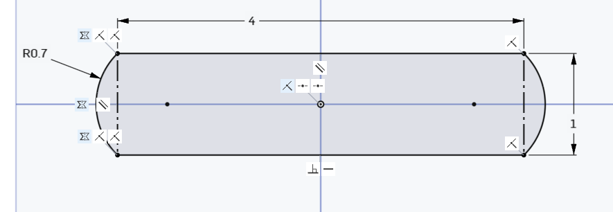

  • glen_dewsburyglen_dewsbury Member Posts: 1,260 PRO
    A centered rectangle and a couple of 3 point arcs (mirror first arc to save time and easier to update) will get you there. Make the vertical line construction.

  • WtchckWtchck Member Posts: 6
    Very much appreciated, thank you! I was able to replicate this.
