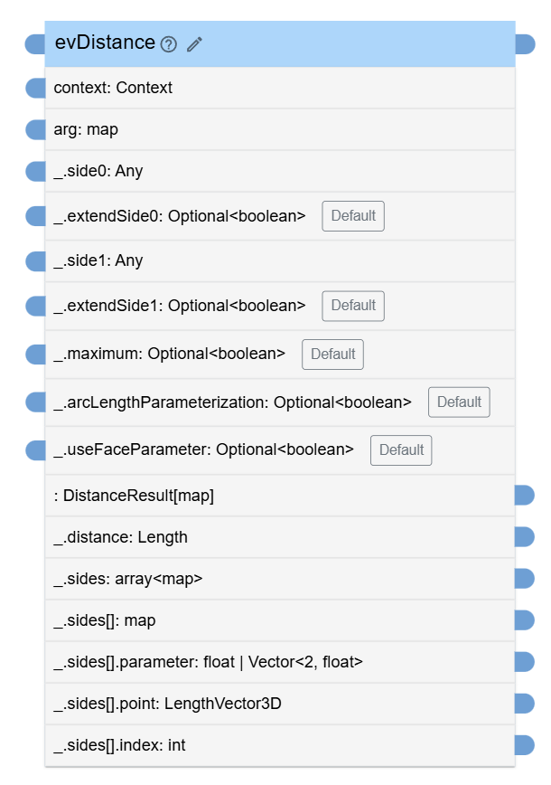

It aims to abstracts away the most cryptic parts of Featurescript functions - the id's manipulation, and represents each function instance - the building block of your custom feature - as a diagram node with inputs, outputs and the links connecting outputs/results of functions with inputs of other descendant functions.
It has a special grouping constructs to represent well known code statements like if-else, try-catch, for loop, and embedable raw code fragment. It enforces type safety of passed values by checking type matching of source values and consumer argument type, so type annotations are your friends not just at runtime 😏 (but not be afraid, the unchecable Any parameter type will let you bypass type checks as we used to) . The tool has full publicly documented Onshape standard library set of functions and types.

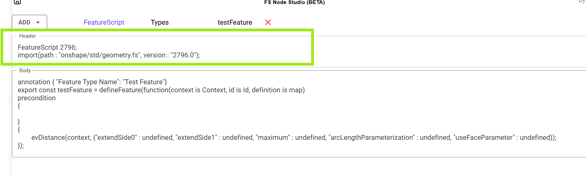

The tool is capable to generate full FeatureStudio declaration code including custom types, enums, top level functions and custom features, except the import statements and FeatureScript version directive.
Also the current limitation is that you will not be able to save you diagram within Onshape tab and you will need to manually copy code from featurescript output of the app to FeatureStudio tab.

@S1mon You can open FS Node Studio (BETA) from the app menu (Bottom left +) then when finished copy your code over to a Feature Studio. However, currently it is not saving the data anywhere. So if you close your browser tab and open it again, your data will not be saved unless you have copied it over to a Feature Studio.

Recently added support for interactive committing of code changes to the satellite feature studio, which is created and binded once app element is initialized. Now the generated code updates as user editing the diagram.
