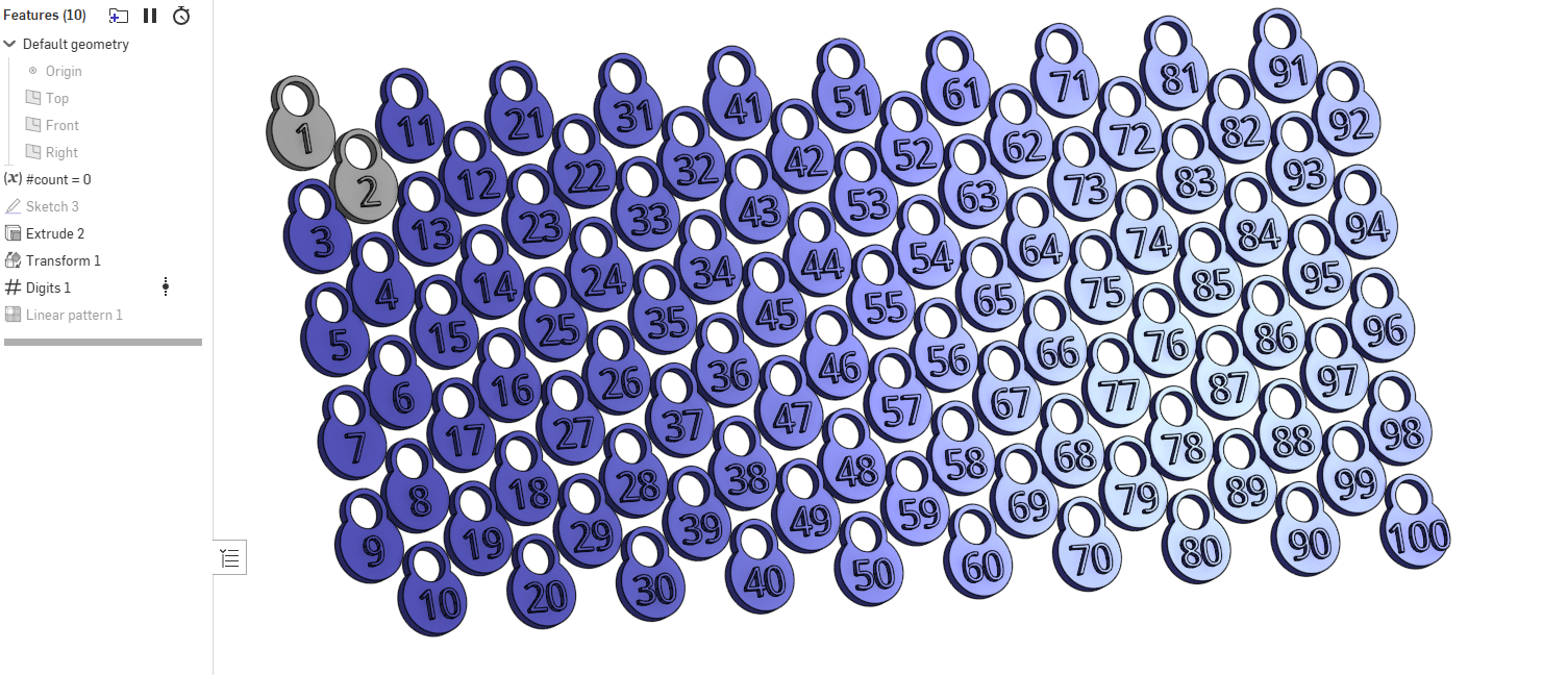

What is the easiest way to apply consecutive numbers from 1 to 100 to these signs?
I would like to print them with numbers in 3D.

I was going to recommend a feature pattern, But it appears that feature patterns are currently broken.
At least for this document. The numbers should be iterating. Edit: Even the text custom features aren't working anymore.
https://cad.onshape.com/documents/057f1c88653d3032be0e9781/w/09e3245db1ddc04ac30d6134/e/e88…
Here is an example of how to do it using the Digits feature I made a while back. I made it specifically for things like this. It isn't completely finished yet, but this is the first time I've released it to the public, so cheers!🍻
https://cad.onshape.com/documents/057f1c88653d3032be0e9781/w/09e3245db1ddc04ac30d6134/e/3f92af9c31f7cb1e3b67f…
Yeah, sorry, we have a bug for sketch text expressions not updating in feature patterns. I believe the Text custom feature will work: https://cad.onshape.com/documents/4e187c2b2f7f4974f4e2b612

this digits feature works very well! Thank you very much. I admire people who are able to programme such a feature.
I could print my signs, but they were too small. I enlarged them and then had some problems with the distribution of the signs, which initially overlapped in places, but I managed to sort it out in the end.
