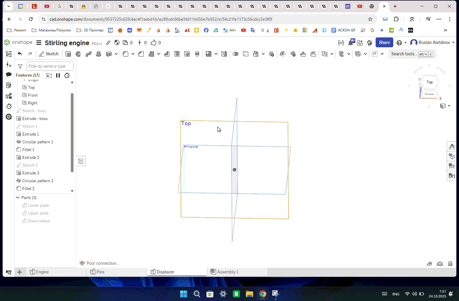

Onshape started to extrude surface not a solid object from sketch.
iRupertiRupert Member Posts: 4
Good day everyone.
Usually I extrude it directly from the sketch and Onshape start to extrude solid object.
But for the last two days, whenever I try to extrude from different sketches (I am not closing sketch and start to extrude immediately), it starts from the Surface tab. Maybe I missed some sort of settings? I tried different laptops, same issue.
Thaank you.

    If someone else have this problem here is how I fixed it - two or three weeks ago, I was editing a model in the Android mobile app, and the last action I did was working with surfaces. Apparently, OnShape prioritizes app actions by default, because I've already tried four laptops, and the sketch always extruded as a surface first.
    Now I opened the app, extruded the sketch as a solid, and everything worked fine on all my other laptops.
