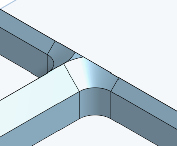

Now I would like to add fillets/chamfers to the grid part.
On the image below, I would like to be able to select a face, and apply a fillet/chamfer to it, but exclude the outer edges of the piece (target only the "cell" holes)
That is because when I manually select all edges and apply the chamfer, if I update the variables (e.g. more/less cells), the feature either :
- has an error saying not all edges are included (for fewer cells, because it indeed removed some)
- has no error, but only includes some cells (for more cells, because I manually selected only a few)
By doing this way with the face, it works great, but the issue arises when using applying the feature : the outer edges are 1/2 of the inner edges and hence, the feature is not equal on the outer parts, as shown on the image below
I fiddled around and found the "remove face" with "heal" mode, and it works sometimes (for a small amount of cells like 2x2), but other times it does not, either erroring or doing random things.
What advice would you give me for this particular use case ? Can something be done easily, or should I just give up ?
Thank you in advance
Don't give up! This is a textbook case for the new and awesome Query Variable (we introduced it August 29th, 2025)
Have a look at this copy of your doc - I created a Query Variable (QV) called
inner_edgeshttps://cad.onshape.com/documents/fdf6c8699cbf7651ea024a66/w/eab2b40371183599cfd295d9/e/8debe68e491972cf3e03fcdf
The fillet feature then references this QV. There are many ways you can build the query logic: in this example I choose all the loop/edges of the selected face, then subtracted as second query from that (to get rid of the outside edges)
Hello @GregBrown, that is perfect and works like a charm, thank you very much !
