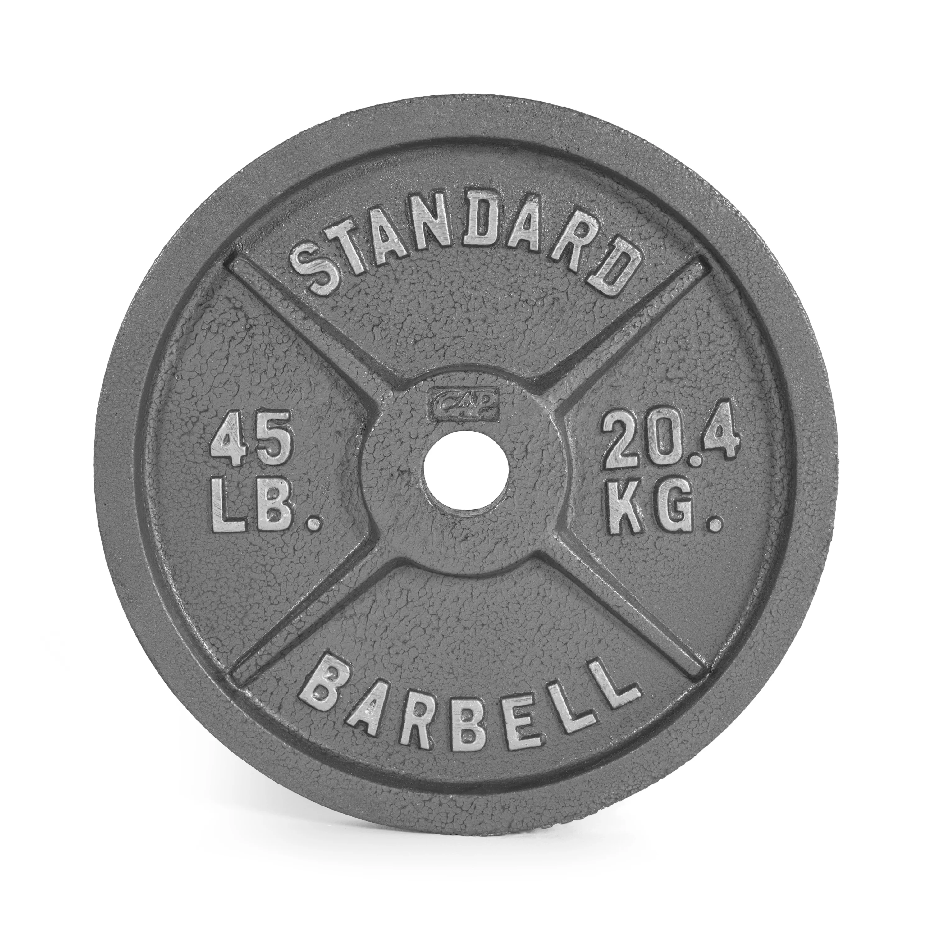

I'm stock in this project. Trying to create a gym plate but can't figure out hout to extrude so the dept or height of the sketch is not regular in the whole piece which I'm assuming could be achieved by giving an "angle" to the extrude fuction. Pictures for reference. Thanks in advance

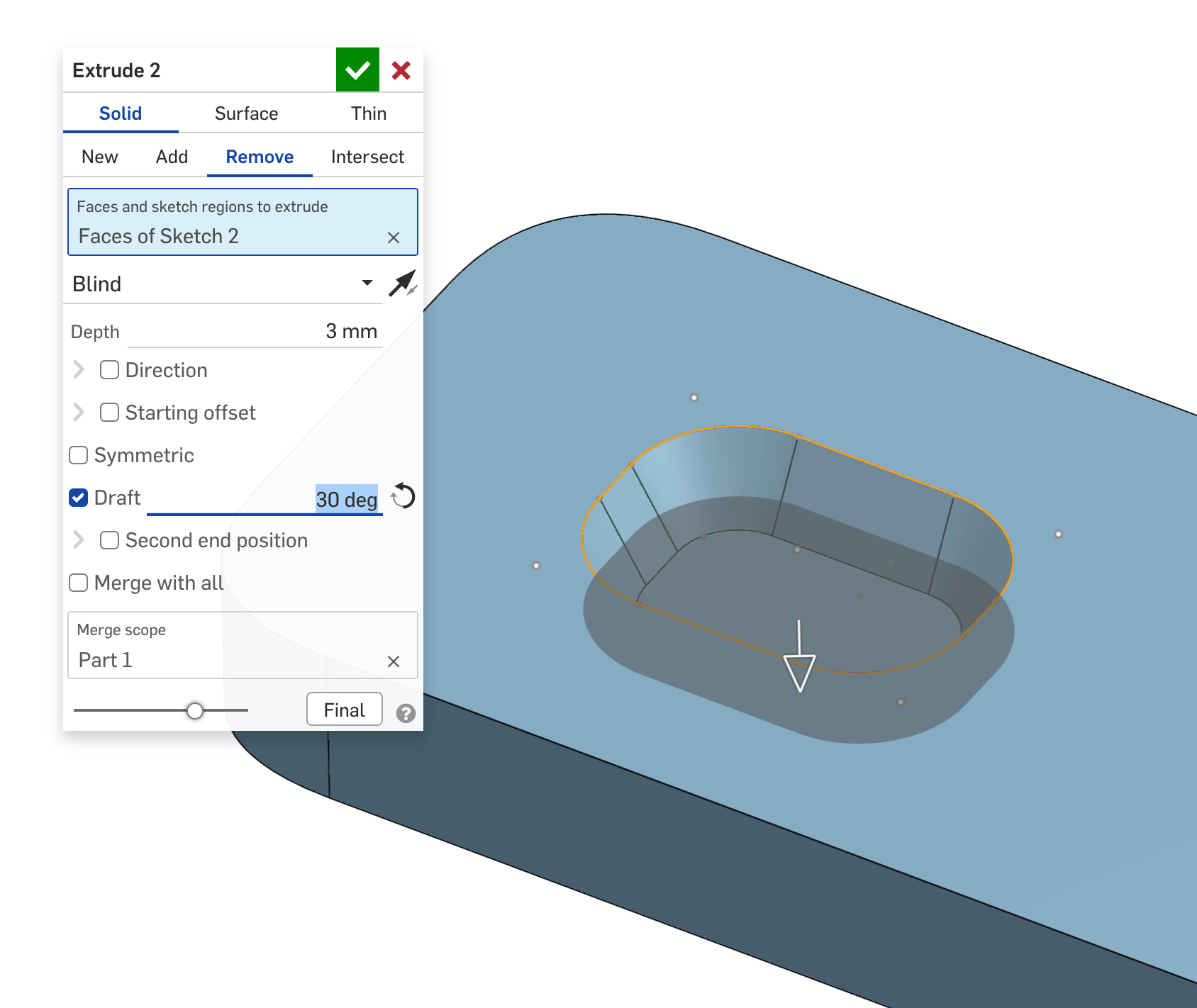

    I think what you need is 'Draft' which is an option in the Extrude Dialogue window. Click the curved arrow to reverse the result

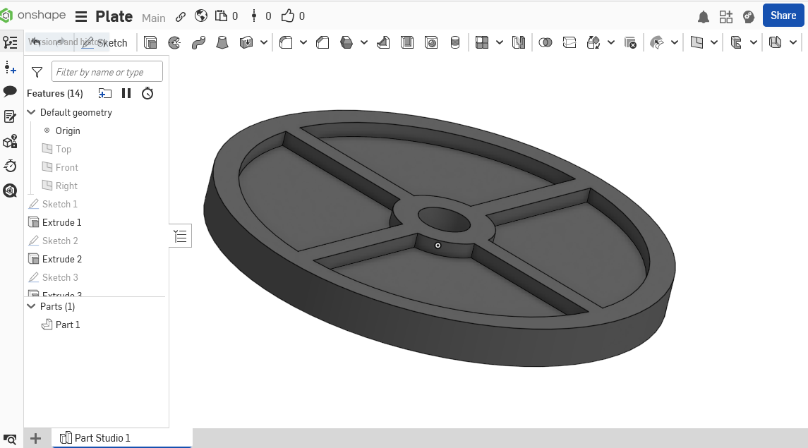

  • angelo_consuegraangelo_consuegra Member Posts: 5
    The ribs tool was useful the design now looks very similar to what I pictured in my head, can still play with the fillets/chamfers to change it a little bit but I´m pretty okay with it so far
