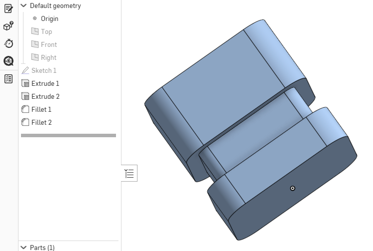

                    Hello Everyone,
I am trying to create a shape like shown here in onshape. For some reason I am not able to use the wrap feature to cut a groove like this in the shape. Any idea how this can be achieved?
Any help will be appreciated.
Hello. Sweep-Remove would be the tool to use. Document. - Scotty
you can also make a square, extrude it, make a smaller square on that and extrude it for the groove, then another square on top of that the same size as the first one and extrude it.
There are a lot of functions in this program, but a lot don’t really work, or i don’t understand how they can work because it doesn’t make any logical sense.
it
It's most likely the latter. Have a look here for enlightenment learn.onshape.com
I'm with MDesign
Learn OS first before moving on. What you're looking for is a straight forward design criteria. A couple extrudes are all that's needed. No need for more complex features like wrap.
https://cad.onshape.com/documents/9a16e90e97ff0f49350854fe/w/8b1147e1bb96ce49e97d63d0/e/6044e2dee2846ee53d536a60
