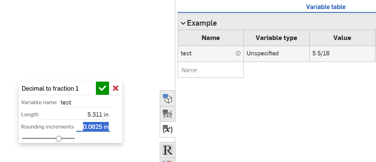

    Looks like this was already solved a few times over, but here is a similar feature for this incase future users need something.
    Decimal to Fraction
    https://cad.onshape.com/documents/0ac50e48c2cd6af90faa62a8/w/256a5d01d7e4265ac46fed…

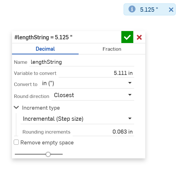

    This prompted me to rework Variable to String to be more useful. I don't know that I ever made an official forum post for this one, but here it is.
    image.png Variable to String
    https://cad.onshape.com/documents/19dacc01596e7c326bbfb137/w/0567dd7ffac5327836c9bb93/e/cd2c8c665d8a4b00a…
    RENDERCAD
  • eric_pestyeric_pesty Member, pcbaevp Posts: 2,581 PRO
    Well well well, that pretty much solves everything:
    I like it but I actually have a request: could we have the option to either omit the "unit" from the string?
    My use case is to build a string that says something like DiameterXLength" so I don't want anything after the "diameter" part.
    It would save me having to do something like this: substring(#IDVar,0,length(#IDVar)-2)…
