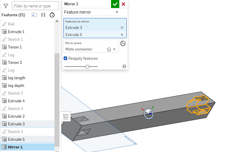

I am a complete beginner and I have hit a brick wall. For a very simple woodwork project I have created a rail 25 x 40 x 400 mm. I have created a tenon on one end using "extrude - remove". I now want that same tenon on the other end. I have exhausted my free goes on Chat GPT and I think I have tried everything! In the "Mirror" dialogue box I have selected "Feature Plane", I have tried the midpoint mirror plane and the opposite end mirror plane. Nothing seems to work. Any help would be very gratefully received as I'm completely stuck.
Thanks in anticipation.

    hard to visualize what could be the issue with no visual or doc link. But have you tried using a mate connector through the mirror plan selector?

    If you are trying to use the assembly mirror feature you need to select a mate connector to define the mirror plane.

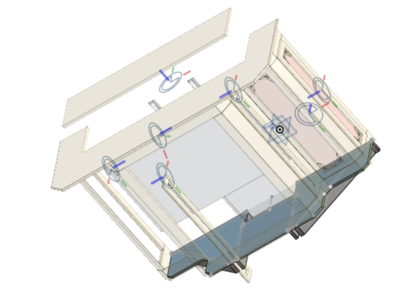

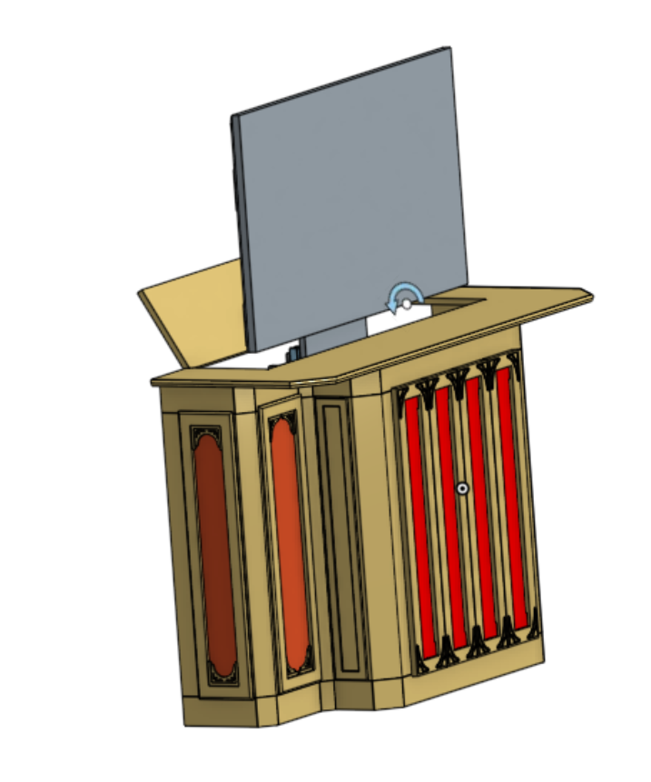

    Hello Patrick. I think your current impression of the limitations of Onshape in the free version may be wrong. I too am a hobbyist, mostly woodworking. I have been an Onshape user for 7 years. Unless ultra-simple, all of my projects use Onshape to create my project or jigs and other aids to enable a feature or operation of that project that otherwise may not be practical, possible, or may eliminate being risky.
    Seems you have initially come upon a frustrating stumbling block that leaves you with thinking Onshape is not a usable resource. After your searches for a resolution have come up empty, you have come to the right place. I have very little doubt that it is fixable. It may not be the Mirror feature, but something created beforehand or something missing that Mirror needs to be successful.
    Besides Onshape being loaded with the tools needed to create, a valuable tool is this forum. Please post a link to your document so we can help you out. - Scotty
    Not trying to show off. Just want to show how Onshape has enabled me:

    Just to address the Mirror problem you originally posted, this copy of your document uses the Mirror tool to accomplish that. - Scotty
  • MDesignMDesign Member Posts: 1,343 PRO
    You can also use a mate connector with the mirror feature and skip the separate plane feature. If the mirror plan will be used for more than just this feature it is good practice to create a separate plane for later use.
