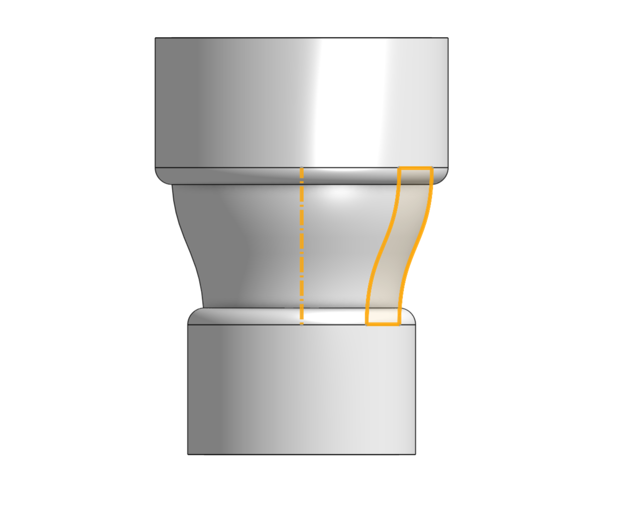

    Do you mean like this?
    But seriously, here is an example of how to do it.
    Create a sketch of your profile, then use the Revolve feature.

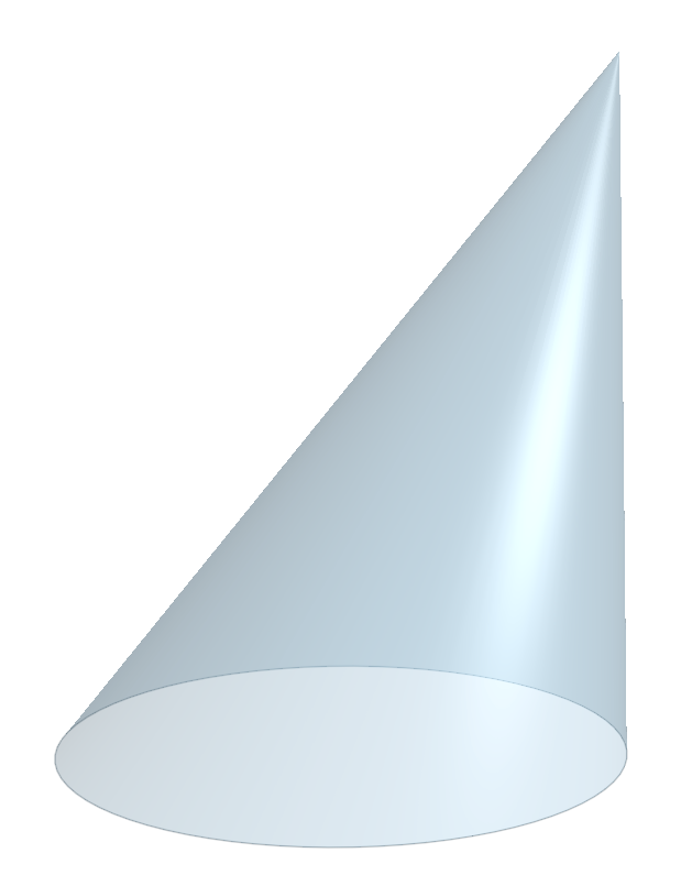

  • GregBrownGregBrown Member, Onshape Employees, csevp, pcbaevp Posts: 370 image
    How about by lofting from a circular section to a point?

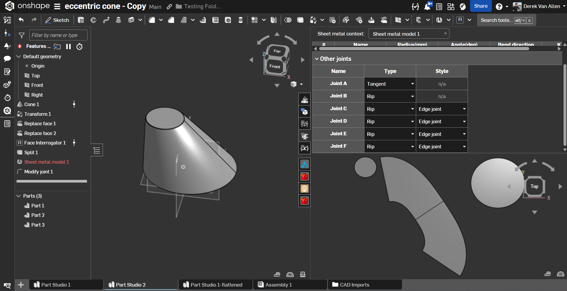

    I need a flat pattern of the eccentric cone
  • S1monS1mon Member Posts: 3,857 PRO
    Until lofted sheet metal is released, you'll have to use the Flatten tool to do it. It's not parametric, but it will work.
    https://www.onshape.com/en/blog/cloud-native-cad-simplifies-surface-flattening
    https://cad.onshape.com/documents/9d719a67b9be8b97a03605e2/w/4ce93f49ecfdd55d9a30a17f/e/93ad86c59525f374356aa768

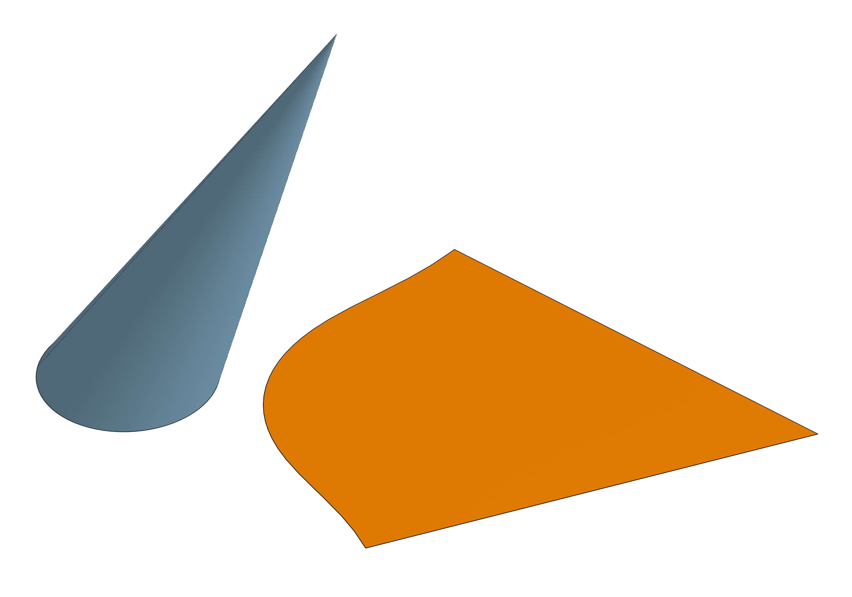

  • Derek_Van_Allen_BDDerek_Van_Allen_BD Member Posts: 581 PRO
    So from a purely pedantic perspective (and the one that the sheet metal kernel abides by) the examples by @S1mon and @GregBrown aren't true cones because they'll have a slightly elliptical profile and thus different amounts of curvature across the folded faces. If the constraint you're looking for is an eccentric loft between two offset perfect circles, the method @S1mon shows is the closest you'll get with the engine today. If instead you're looking to enforce a true conic shape for manufacturing in a sheet roller for example, and don't care about the end profiles you're better off drawing the cone with a revolve feature and chopping the faces off where you want them, at which point the sheet metal engine is happy to unfold cones as-is.
