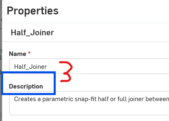

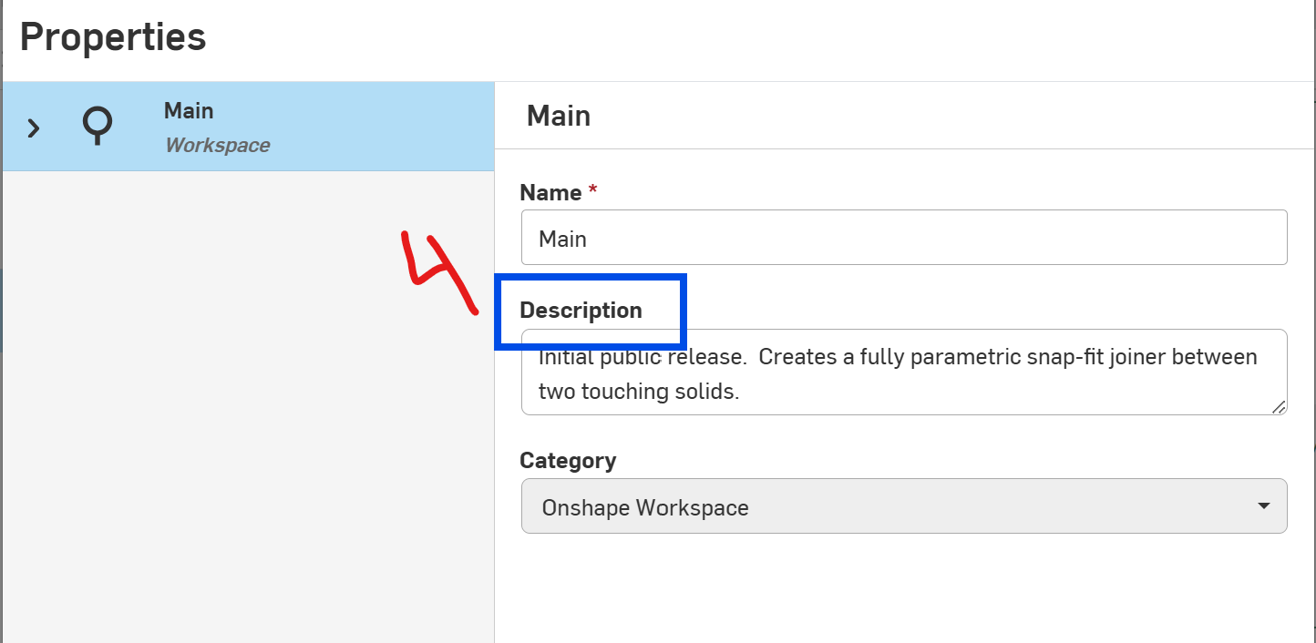

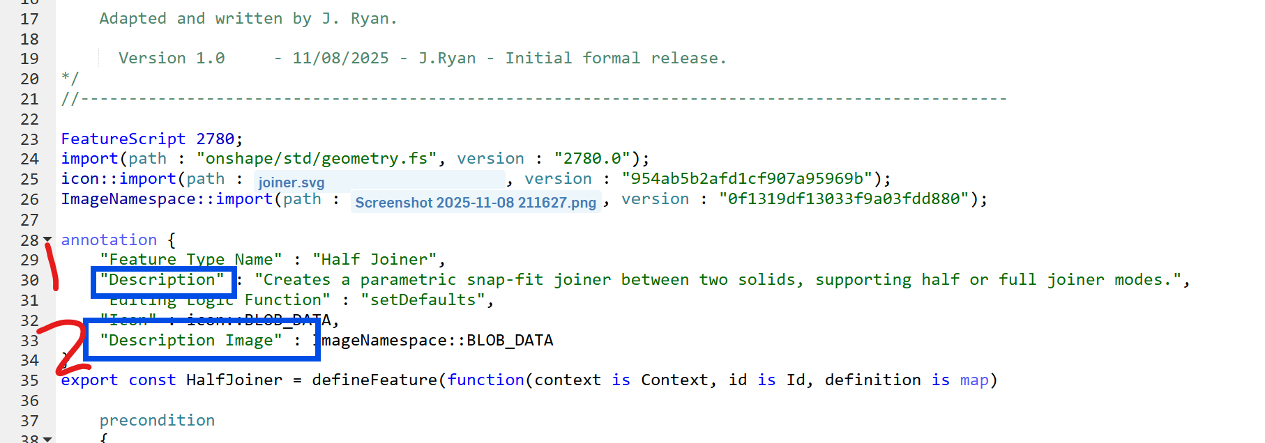

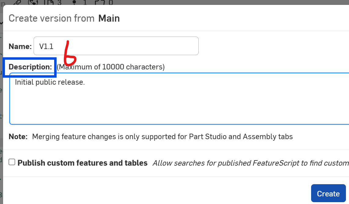

Hi all,
I have a feature script ready to publish, but it is being blocked saying it is missing a description. I read the ? post which said to add a description photo which I did and it didn't work. Since then I have added descriptions to at least six other locations all called "description" and it still does not work. Please help, this is so frustrating. Even this site is frustrating as I keep posting replies and questions that are also not being published…

  • Derek_Van_Allen_BDDerek_Van_Allen_BD Member Posts: 595 PRO
    @jason_ryan337 looks like you found the solution already but for anyone coming after looking to publish and running into this issue, the "Description" field on the feature definition needs to be labelled "Feature Type Description" instead. It's a subtle thing I ran into when I was first publishing some of my scripts that isn't obvious from the notification alone because none of the standard library scripts have this field filled out for their feature definitions. It is documented in the UIspec page for featurescript though.
