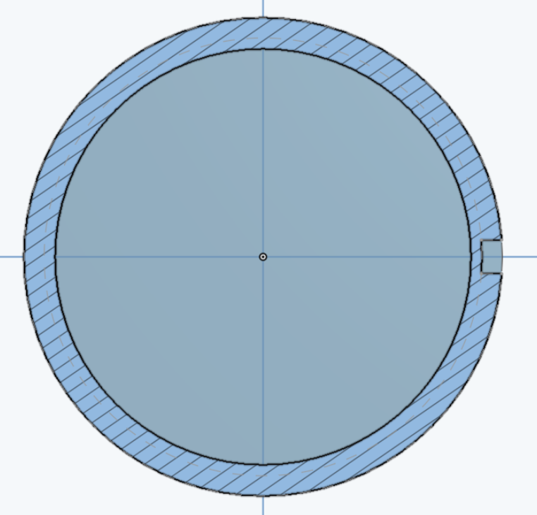

  • kenn_sebesta167kenn_sebesta167 Member Posts: 113 ✭✭
    I like this!
    Two issues which arise as I use it:
    1. It complains when the layer resolution isn't quite fine enough for the requested thread. That's good to have some feedback, but as things stand there are two improvements I would ask for: 1) don't elevate the issue to a failure. It's not great to see red in the feature tree, and this wouldn't seem to be that critical. 2) If the script knows what the max acceptable layer size is, it should communicate that to the user, as otherwise the user will have to guess to find the right layer size
    2. There's some kind of weird overrun issue I'm seeing when I choose a cylinder to thread. You can see in the below screenshot where the selected area is the cylinder in orange, but it knocks out a huge cone from the part (removed sections in transparent). This is a showstopper, and I can't seem to find a workaround in the part studio.
    A feature request would be to be able to choose multiple holes in one operation. It clutters up the feature tree to have a thread operation for each and every hole which needs to be threaded. And because a print truly needs every threaded hole to be threaded in the CAD, the ThreadCreator approach of only threading symbolic holes doesn't translate well.
  • william_knoblauchwilliam_knoblauch Member Posts: 21 ✭✭
    Hey @kenn_sebesta167,
    Thanks for the comment and recommendations. I'm sorry I didn’t get back to you sooner. I haven’t looked at the forums in a little while.
    I changed the layer thickness error to show up as a tooltip and to show the “correct” layer thickness. Of course, by “correct” layer thickness I mean the layer thickness ensuring that a single layer captures the flat section of the thread profile. This is an estimation of what would work and in my experience, it prevents tiny threads from printing with too little detail/resolution.
    The error you are getting with the cone removing geometry from your part is an oversight on my part in testing. That is the chamfer cone cutting the chamfer on the threads at the exit of the hole. The chamfer cone should scale with the pitch of the threads to not interfere with the rest of the part but in that circumstance, it was not scaling correctly. I have fixed the error so you can thread the hole without it cutting into any other section of the part.
    I also updated the script to allow for many hole and stud selections. The main reason for holding off before was to prevent users from creating 10+ threaded holes/studs and then lagging the part studio until it is unusable. I realize now that kind of “hand-holding” really isn’t necessary and everyone is smart enough to figure out that this is a pretty heavy feature script to run if you have multiple starts or really fine pitch threads. The script is actually quite optimized but the predominant bottleneck for performance is the sweep and union functions which each can take hundreds of milliseconds to solve (When you add up ten 200 ms sweeps you're waiting for 2 seconds just for the part studio to load).
    One last thing, in the picture you uploaded you selected a threaded M3 hole and I wanted to let you know that this script was not designed to interface with any standardized threads. If you want to, the hole/stud size needs to be the same diameter as the external thread of the corresponding bolt. So for an M3 screw to thread in, the hole would need to be 3 mm and the pitch 0.5 mm. External threads act like a die and cut into the cylinder while internal threads add material to match the external threads given the same diameter. This means that internal and external threads from the same diameter cylinders match and thread together.
    With these changes, I updated the UI so it is easier to see how the more advanced features expand the functionality. I hope you can finally use this feature script how you initially desired. Let me know if you have any more issues so I can resolve them.
    You can find the new version here (Plastic Thread) or you can just update the feature in your tool bar in any part studio.

    Hi @william_knoblauch. Thanks a lot for the feature.
    However, I have one problem with internal threads. I designed a container based on two circle and added a thread to the two parts. As I require a slot in the container, I noticed the threads create an extra wall, although I specified that the threads should have a length of 5 mm. Any way to avoid this (except for splitting the cylinder into two parts?
  • boris_böhlenboris_böhlen Member Posts: 4
    Thank you @william_knoblauch for this great feature as it is perfect for 3D printed parts.
    However, I'm struggling to get the internal threads done. Basically, I'm trying to create a threaded container. So just two circles extruded to two different parts (I would move the face for the inner part of tha part for tolerances).
    For creating the thread I select the outer face of the lid AND the inner face of the cylinder. However, for the face of the cylinder it complains that the selection shall not be an inner cylinder. I looked at the examples I see no difference to what I do. Any suggestions?
