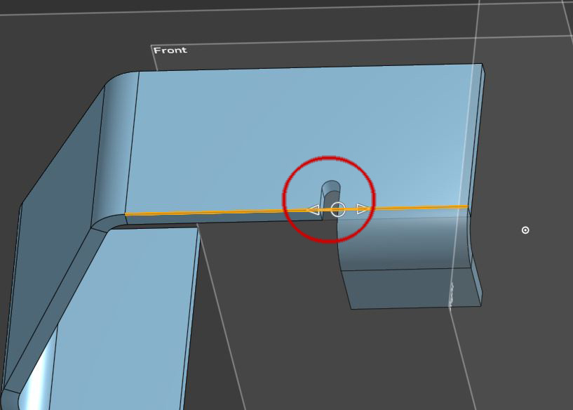

At approximately the 8:20 mark, he used the Flange command. I did the same, but the model generated this odd recess, which you can see highlighted in red in the screenshot below.
I didn't understand how to fix it.
here is the link to my project:
Could you please help figure it out and fix it? Thanks
  • eric_pestyeric_pesty Member, pcbaevp Posts: 2,467 PRO
    Check your relief type in your first sheet metal feature. Looks like it is set to "obround". If you set it to "tear", it won't create that relief cut.

  • john_torjohn_tor Member Posts: 19
    Ok, I fixed it by modifying the Bend relief option in "Tear"
