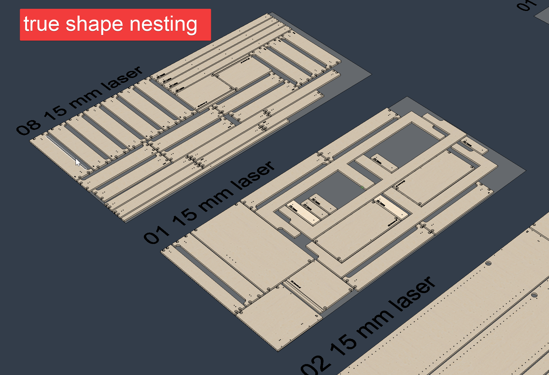

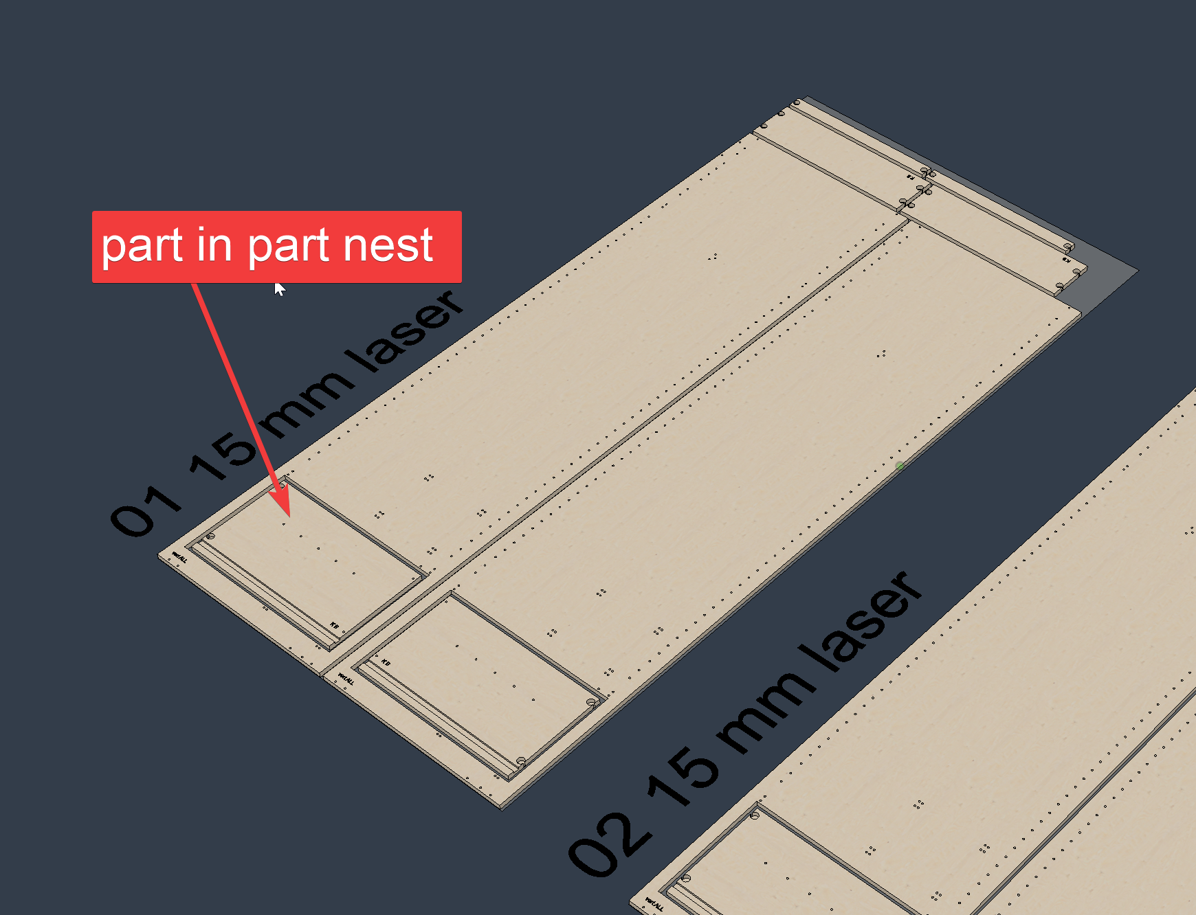

  • troy_ostrandertroy_ostrander Member Posts: 25 ✭✭
    edited November 22
    Hi @chadstoltzfus,
    Can achieve part in part and true shape level of nest efficiency with your Auto Layout Mod?
    Best, Troy
  • chadstoltzfuschadstoltzfus Member, Developers, csevp Posts: 167 PRO
    We haven't done anything with that but I'm sure it's possible, the sorting algorithm they use is right in the code so with some tweaking what you're looking for can be done. We've tweaked the algorithm to measure parts differently than the original algorithm, but I think the original does use bounding boxes to gauge part sizes so the part in part nesting would probably require some heavier refactoring. Generally speaking, I like to tell people that if you can do something in a model, you can do it with FeatureScript.
