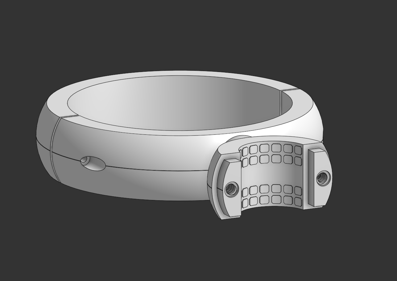

    I'd also like to develop a full (but not actually full) roundover extension to this later for geometry like this:
    But for now we're just gonna ignore that lil line on the circumference.
