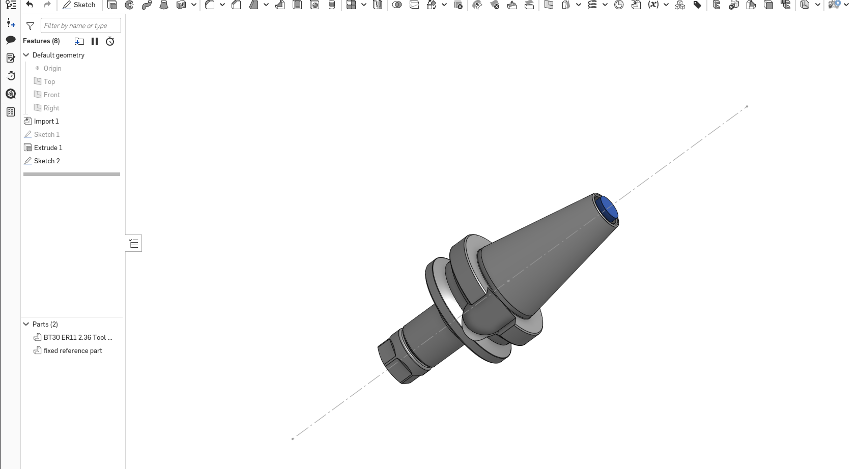

Hi, not new to onshape but I am new to onshape's simulation tool. I'm trying to model how this spindle expands under increased rpm's. The spindle is one part with the 2nd blue part serving as the fixed part in the assembly. I've gone through the tutorial's but I don't see anything that would help me setup a simulation like this. I've labeled the axis of rotation as a construction line.
(please note the screenshot was taken in the part studio but of course simulation takes place in assembly)
