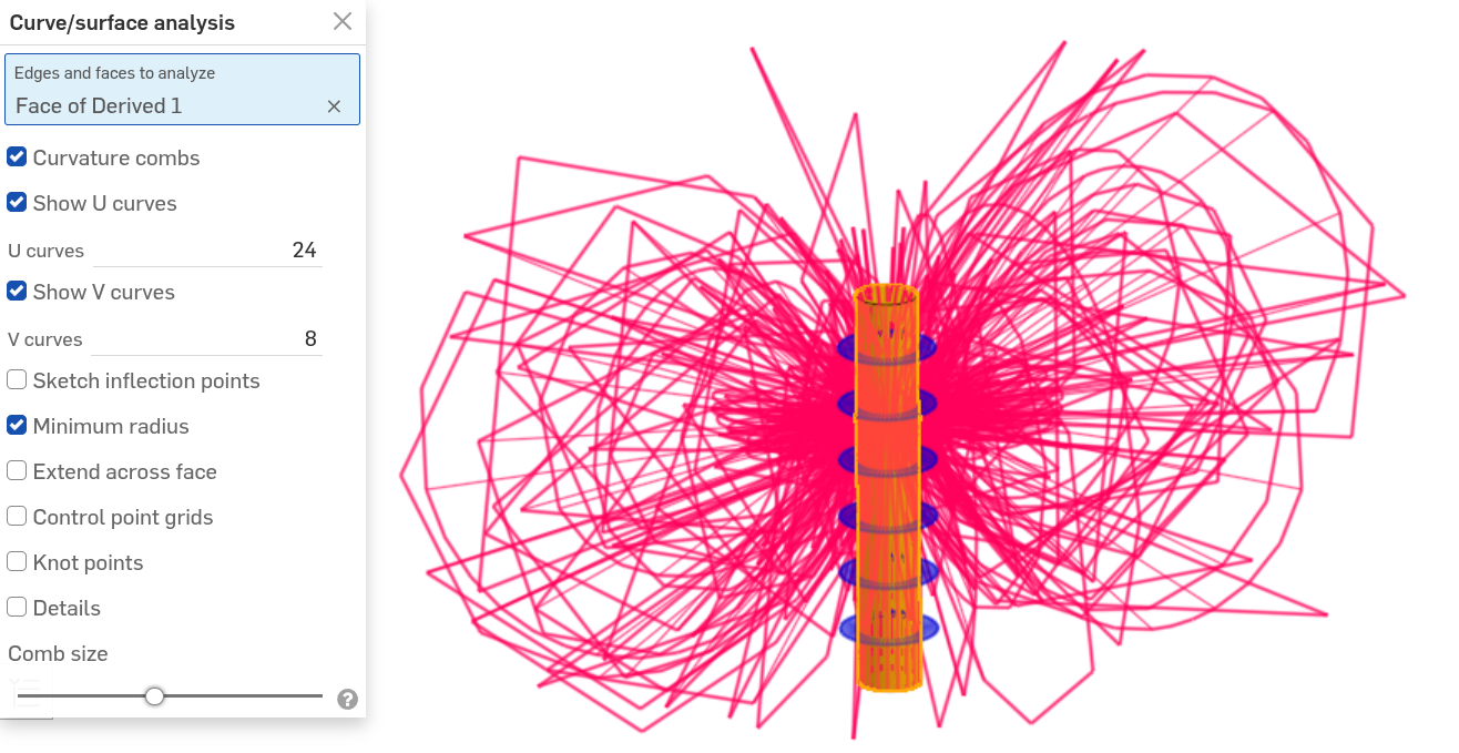

How do I get G2 continuity on a cylinder?

Yeah, the unmistakeable clean curvature combs of a perfect cylinder. Link would help. Seriously it looks like floating point noise scaled up to macroscopic…

very nice V curves though
Wow your surface seems… nuanced.

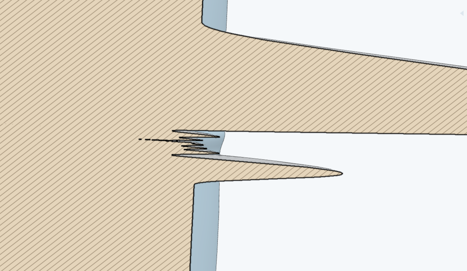

it's really just this one section and no matter how many times I derive it they won't go away!!
