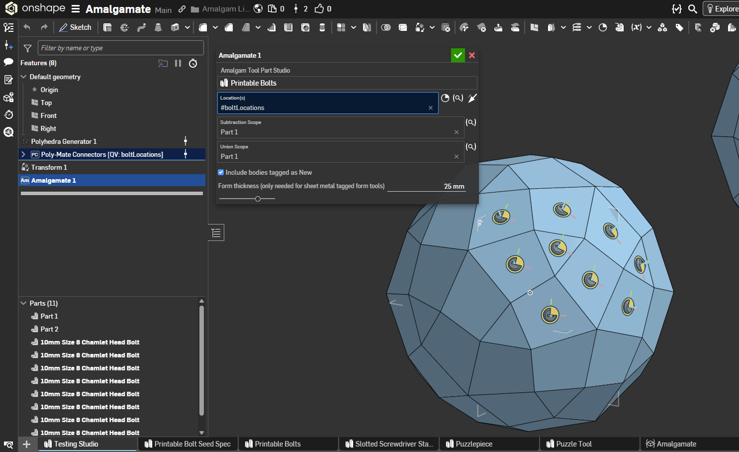

My drafting team have run into situations where they've needed to define multiple explicit mate connectors in one operation for ease of organization and later reference in features. Naturally after searching for an existing tool that does multiple connectors in one operation and not finding one they requested that I develop a quality of life script that does this multi mate connector operation.
Introducing: Multi-Mate Connectors wait that's taken
Introducing: Poly-Mate Connectors
It places multiple explicit mate connectors in one go, so if you need to re-reference them multiple times it's easy to hide and show them all at once by changing the visibility of the feature itself. This makes it simple to drag select the whole window to grab all the explicit mate connectors in frame to quick select locations for hole operations or things not easily defined by sketch geometry.

Latest update brings baked in Query Variable functionality to group the collective of the selected mate connectors for easy dynamic selection in other features. Combine this with my new Amalgamate feature and you can quickly seed and generate complex and robust geometry in far fewer steps than before.

I recently was experimenting with using query variable to generate a selection set for polymate.
I was hoping I'd be able to provide a bunch of circular edges but that doesn't seem to work…
I was able to achieve what I needed using the Query pattern FS with a bunch of intermediate steps:
Works but was quite cumbersome! If I had been able to create MCs on all these edges at once with poly mate, I could have just skipped to the hole feature!
