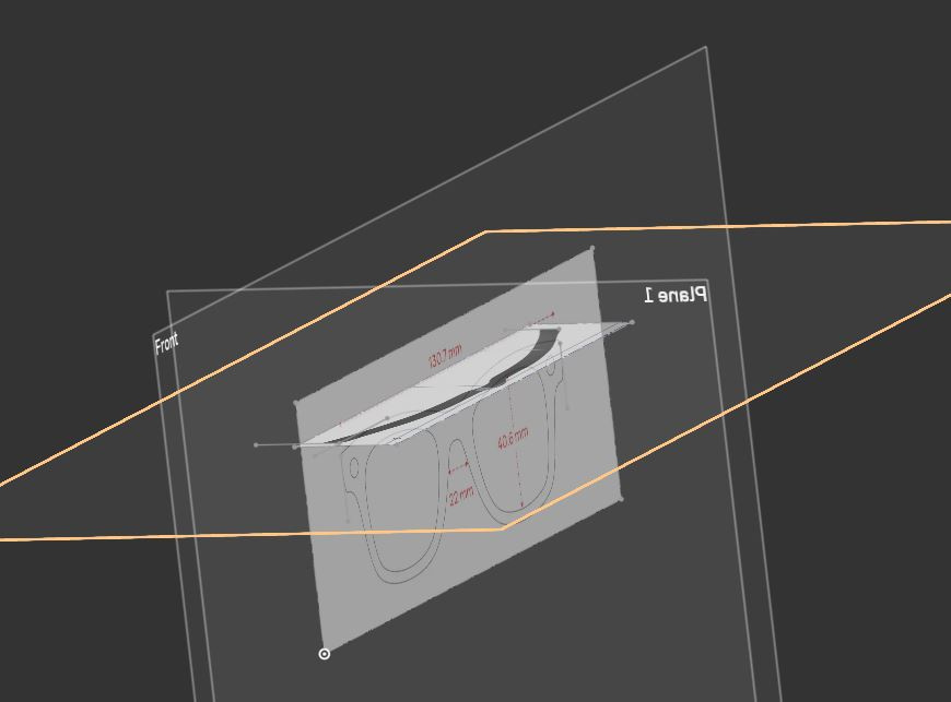

I'm trying to perfectly align two images on two different planes (front and top ones), but I'm not sure that I'm doing it the right way:
Here is the shared link to the project:
Could you please help me understand the right way to do it?
Thanks

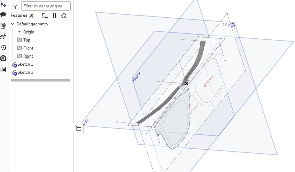

Find a common point and set to the origin will help. Setting scales to make both sketches match size I find a little bit of a pain. Not sure why you felt the need to set up other planes?

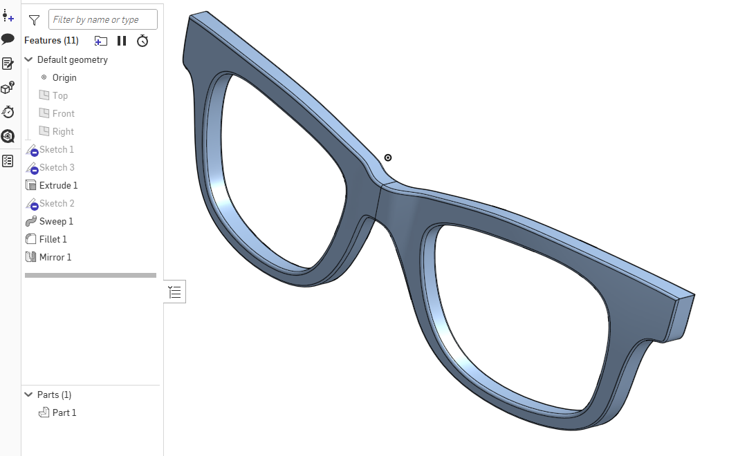

Once the sketches were scaled I used a transform to to move the sketches to the origin using points generated in the sketches. No extra planes needed.
You'll notice I used less input points for the splines to get smoother transitions around the frames.

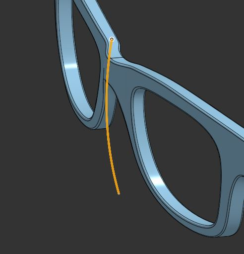

what still puzzles me is this arc:
I didn't understand the criteria of its measures. Sorry, The Video was a bit messy about it.
Thank you again
The arc is a guide for intersect sweep adding to over all shape. That's the shape of the glasses I'm wearing.
I got that, but it doesn't seem to be an accurate measure, I mean it looks to me as it could be of any lenght. Thanks
No it's not an accurate. I't's just a sample and can be locked down any place you like. As to the length, that's some where past the intersect.
Okay. Thank you very much
