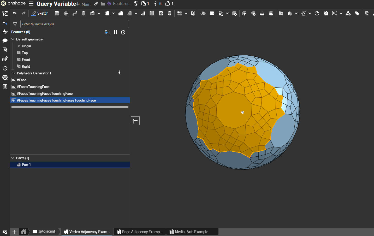

    qAdjacent functionality added. Kinda wild that this one wasn't in the original Query Variable implementation actually.
    If you look closely there's the seeds of another useful featurescript in here too.

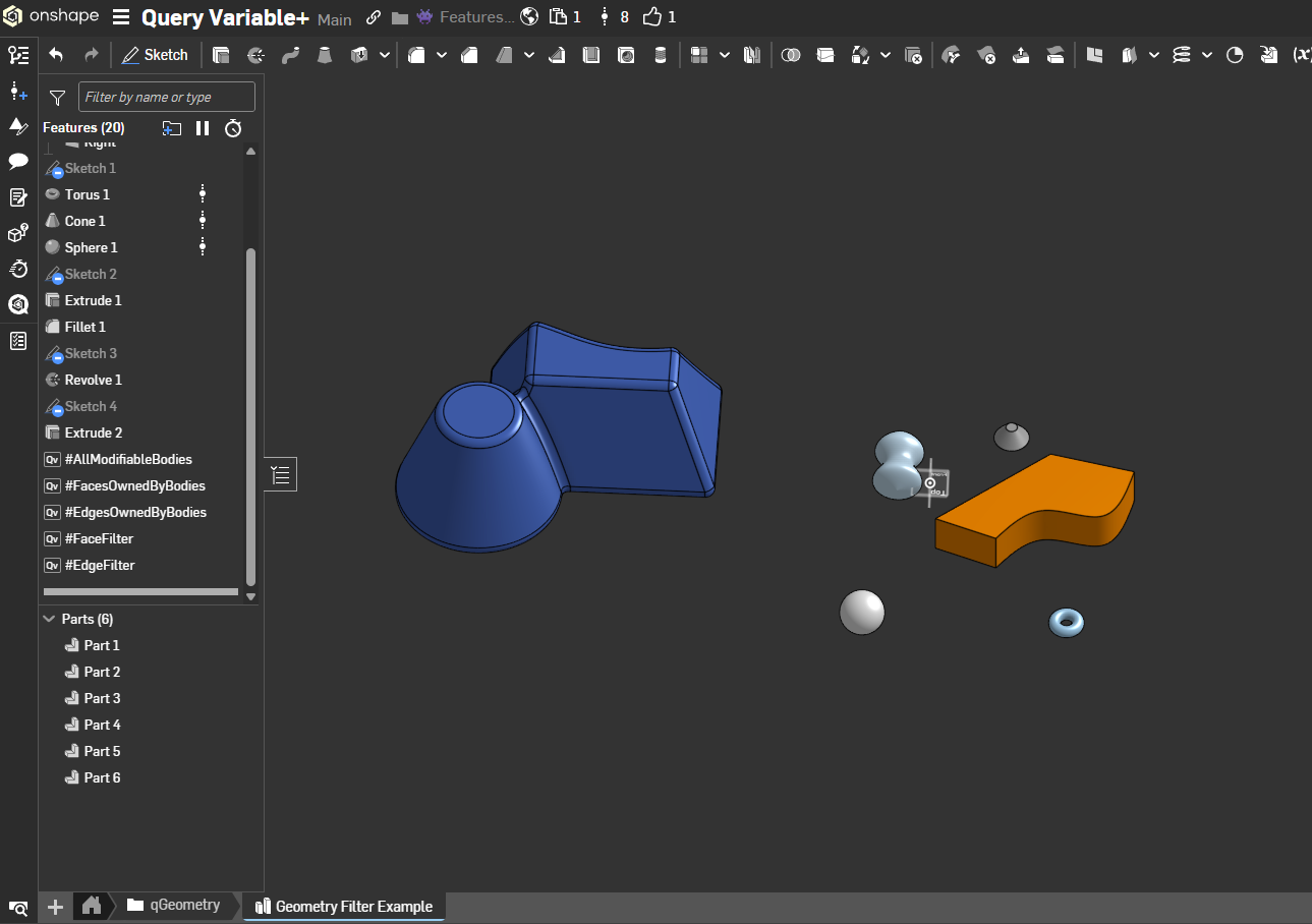

    qGeometry support added. Now you can filter by all the things that qGeometry lets you filter by and use them as an input in future operations. Edge filtering for straight lines vs arcs vs other curves could have some utility for frames features. Face filters have some less obvious use cases but I could see them being handy for working with stubborn import geometry.
    If you're following along with these additions and have suggestions on which query functions to tackle next let me know and I'll slot them into a future update. Probably next is gonna be fillets and direction queries.

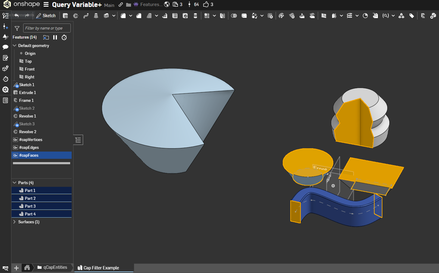

    I was in need of the qCapEntities Filter and created it myself as an additional option filter to "Is Created By"
    feel free to add it to your query variable+ to prevent clutter. I'd rather contribute to your good query variable + version, then create a whole bunch of new ones…
    Just ctrl-F for: "//added by for Cap Filter by Jelte" … "//end added by Jelte" and copy paste those bits. (after a bit of review and checking perhaps):
    https://cad.onshape.com/documents/d235b229e9002129febbb90e/w/4681d88c2fa02968068670d3/e/4243c76ef0022c2f4089c1f7?renderMode=0&uiState=690ddcf38ff2a03fae52d925

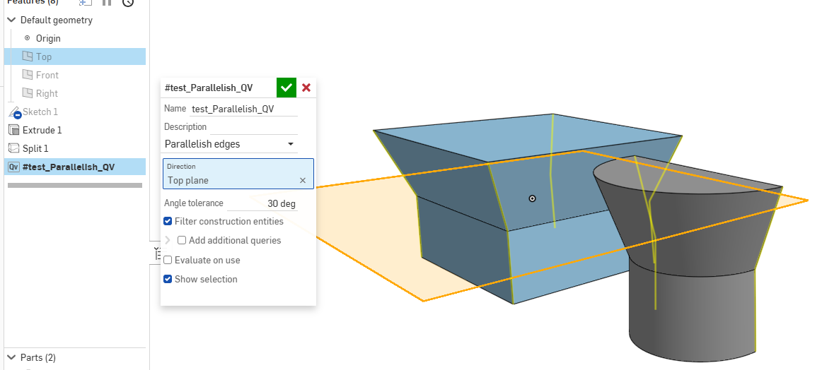

    I've also added a "Parallelish" query in my new version V6. It's a tolerant parallel query that allows a set angle tolerance. Comes in handy to filter for edges with some draft on them.

    some additional feedback @Derek_Van_Allen_BD:
    I used your query Variable + in qAdjancy mode. I wanted to query a face AND all its adjacent faces. I think this is a common use for it. However the qAdjacent only queries the adjacents, and omits the seed faces. I had to add those by uniting with an additional query. It works, but it cumbersome and less robust. if i want to edit the seed faces, i'll have to edit them in two different places.
    a simple boolean in the UI predicate would be nice:
    annotation { "Name" : "Include seeds", "Default" : true }
    definition.includeSeeds is boolean;
    and a subsequent conditional qUnion in the function.
  • Derek_Van_Allen_BDDerek_Van_Allen_BD Member Posts: 928 PRO
    Dang, you've been busy. Nice implementation of nearly parallel edges, I could see that being useful for putting fillets in the XY coordinates on 3d printed parts and not on the top or bottom where they'd look terrible and mess with printability.
    I did develop the qAdjacent filter with the exact opposite case in mind where I wanted to query everything around the seed and exclude the seed on purpose to support draft features, but I could see some use cases where you might want to include the seed as well. I'll get to work on plugging these edits into the main feature.

    qCapEntities support added. Thanks for putting in the work Jelte.

    I expect to use the parallelish a lot to fillet edges of injection molded parts after implementing drafts already. any tranverse fillets will then propagate easily accross the tangent edges…
    @EvanReese my parallelish implementation uses the queryFilterCompound.Allows_direction filter so any direction will work. And it works on multiple parts as well.
  • jelte_steur_infojelte_steur_info Member Posts: 662 PRO
    @Derek_Van_Allen_BD
    I was just thinking about updating the qCapEntities to include a NonCap type next to End/Start/Either, only to find you already made a separate nonCapEntities query! Awesome work! you implementation is probably cleaner as well.
    This catch may also be added to qCapEntities I guess?:
    if (definition.entityType == EntityType.BODY)
        throw regenError("Non-cap queries cannot resolve bodies.", ["entityType"]);
    Yeah I was pondering adding filters at the input level for the entity types to only allow you to select valid types for a given query but that would mean I'd need to split up the input field into several depending on what's valid for a given operation.
    I did start with cap vs noncap being a separate field but because Onshape's standard library has them defined as separate features I did them as separate selections for consistency with how you would actually implement things in a featurescript and with the Query Explorer's implementation.
