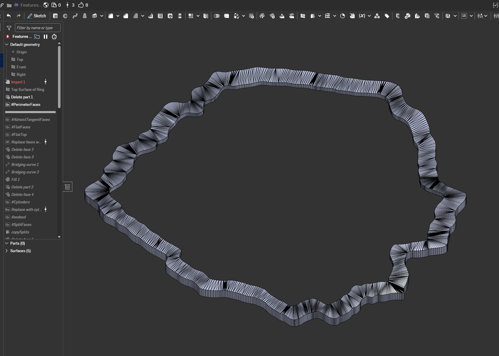

Tangent(ish) Faces
This one is simple, the qTangentConnectedFaces() function in the standard library already has an overload which allows you to specify an angle tolerance for some flexibility in the definition of the word "tangent" so I just replaced the version in Query Variable with this angular tolerance version. This lets me flood select face groups from cursed not-mesh import geometry and use the selections to create patch faces and create new clean parametric surfaces without having a feature tree to work with.
This is not a mesh.
But with a little bit of curve approximation and resurfacing later it can become usable geometry again. Selecting groups of nearly tangent faces made this much easier to execute.

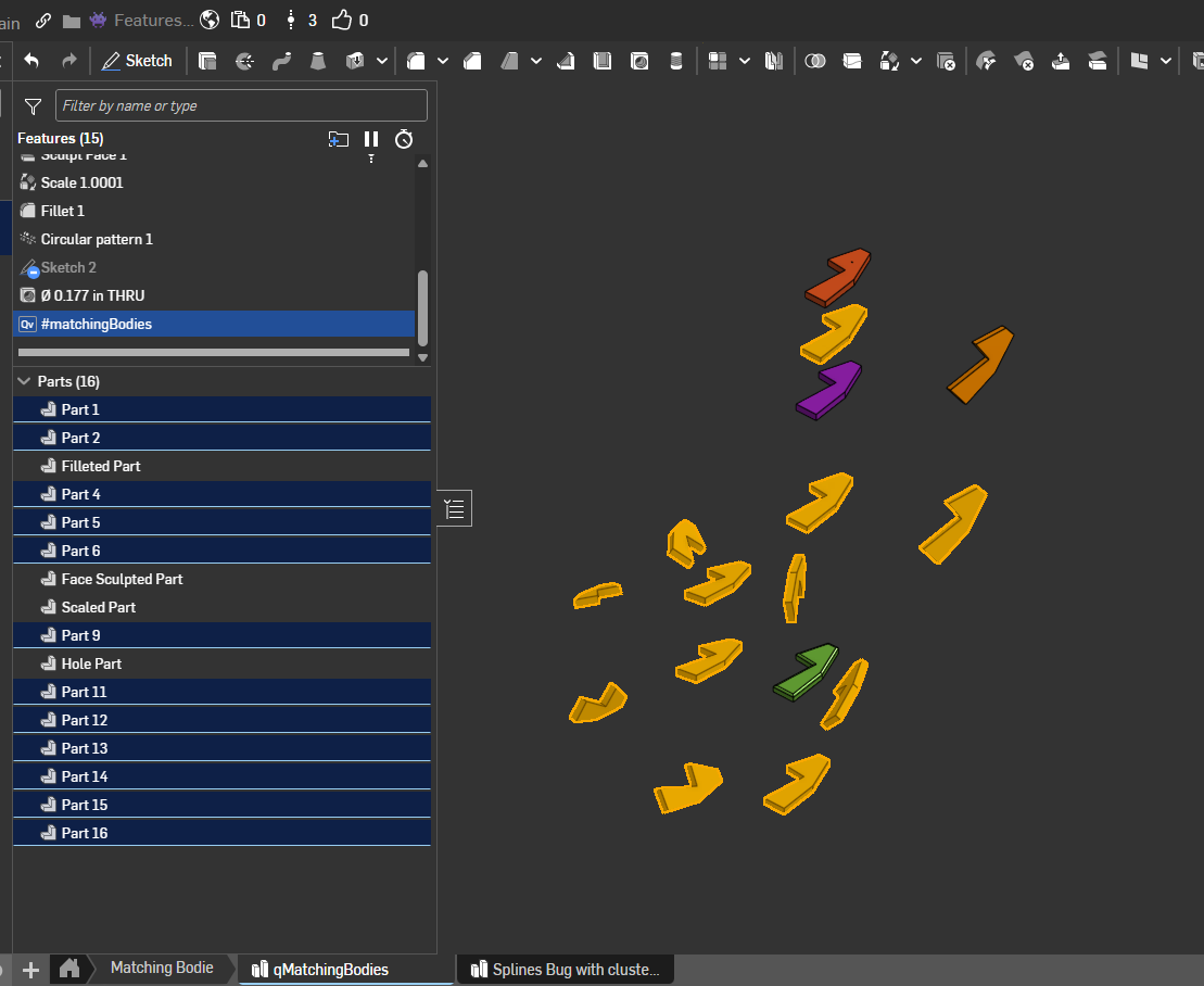

Query Variable comes with the ability to select matching edges or matching faces, why not matching bodies? Well the qMatching feature doesn't allow this selection type so that's why it's not allowed here, but there's a similar function called clusterBodies that does something close to this for cut list purposes. I leveraged this into a qMatchingBodies function that allows you to select a part and the function will return all parts in the studio that clusterBodies identifies as a geometric match for the input. (With some tolerance)
Useful for workflows where you're working with repetitive geometry that's not necessarily the result of a pattern, or if you've willfully ignored the "best practices" instructions of assembly modeling workflows and need to check that your parts actually are still copies of each other at the end of the tree.

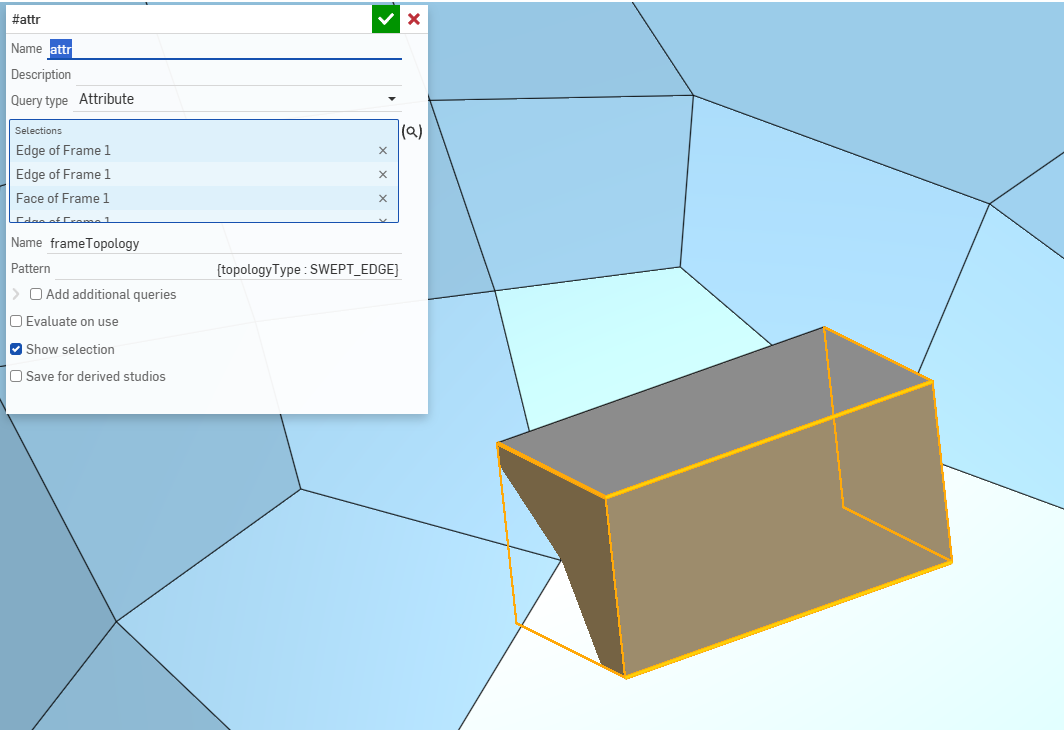

- Attribute filters for sheet metal and frames

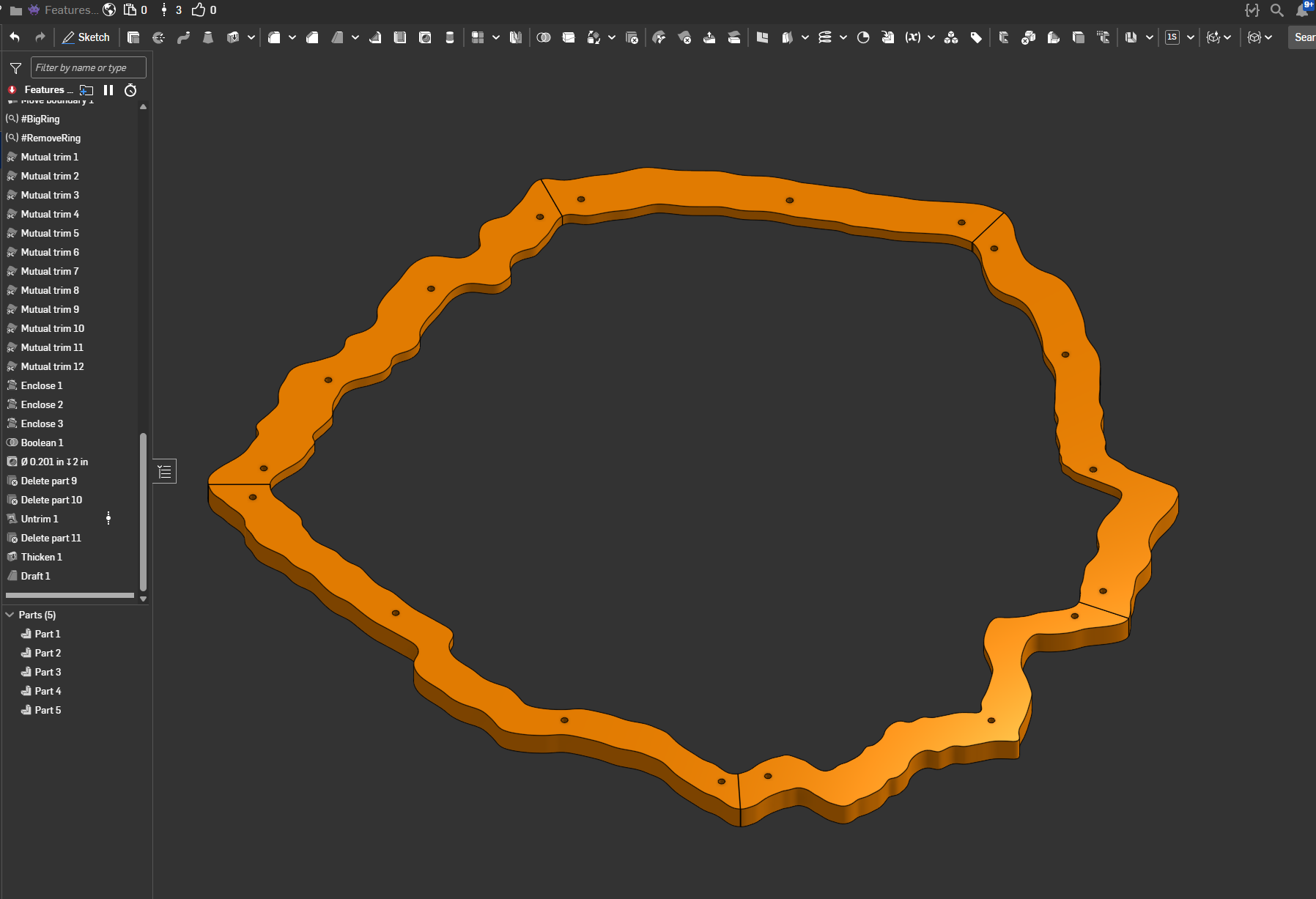

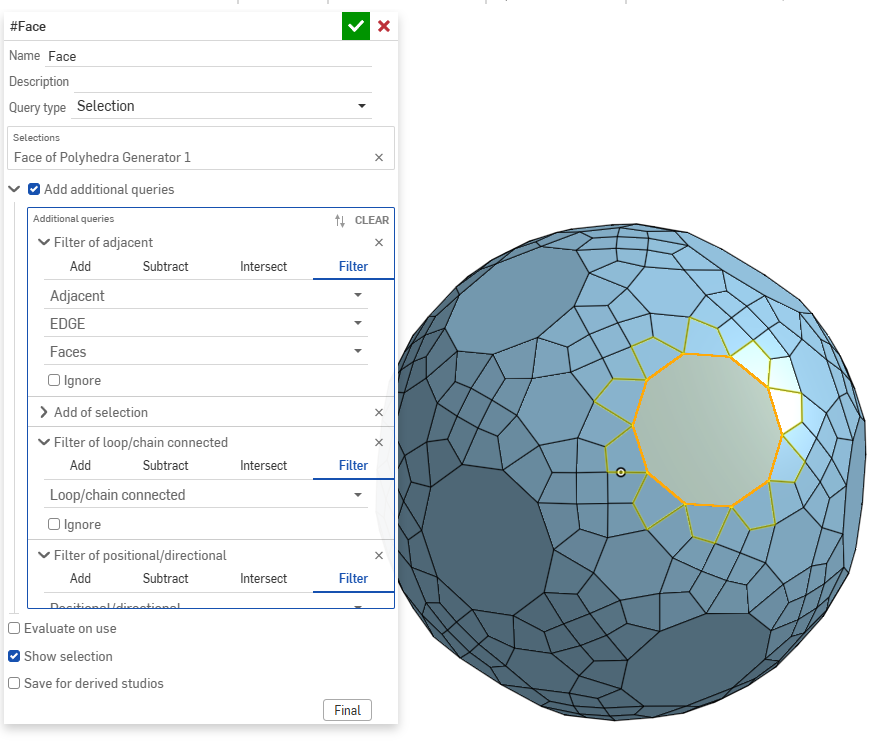

    qAdjacent functionality added. Kinda wild that this one wasn't in the original Query Variable implementation actually.
    If you look closely there's the seeds of another useful featurescript in here too.
    S1mon Member Posts: 4,636 PRO
    Hmm. The Median curves? I had no idea there was functionality for that in Parasolid.
  • Derek_Van_Allen_BD
    Derek_Van_Allen_BD Member Posts: 1,166 PRO
    edited October 2025
    There isn't, as far as I know. That tab is an extrude with an 89 degree draft, a query variable to grab all the edges of that operation and another one to subtract all edges adjacent to the first input face, and a projection of the remainder onto the input face. It's one of a few methods of medial axis approach and is somehow way more performant than the delaunay method I was working on before. Could use some size comparison threshold filtering though, which will be one of the things I add to QV+. Could turn into its own script when the concept is proven, and actually a lot of use cases for QV+ could be turned into dedicated scripts based on concept studios like this one.

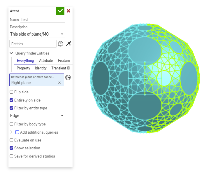

    Yeah yeah okay fine, that update was mid and I could do better. Here's 10 more query options for you all under the Positional / Directional query umbrella:
    • Plane Normal: Takes a reference plane face (positionalPlane) and filters the input entities (positionalEntities) to those with normals parallel to that plane via qParallelPlanes; returns a Query of the matching entities.
    • Intersects Line: Uses a selected linear edge (positionalLine) to keep entities intersecting that line through qIntersectsLine; outputs a Query of the intersecting entities.
    • Intersects Plane: Requires a planar face reference and applies qIntersectsPlane to find entities crossing that plane; returns a Query of intersecting entities.
    • Intersects Ball: Uses a reference vertex plus a radius to select entities within that sphere via qWithinRadius; emits a Query of entities inside or touching the ball.
    • Contains Point: With a reference vertex, applies qContainsPoint to find entities that include the point; outputs a Query of containing entities.
    • Closest To: Given a reference vertex, uses qClosestTo to pick the nearest entities to that point; returns a Query of the closest hits.
    • Farthest Along Direction: Accepts a direction reference (edge or direction-capable selection) and uses qFarthestAlong to keep entities farthest in that direction; results in a Query of those entities.
    • Coincides With Plane: Selects a reference plane and returns entities that lie on it via qCoincidesWithPlane; output is a Query of coincident entities.
    • Plane Parallel To Direction: Uses a direction reference and qPlanesParallelToDirection to keep planar entities whose normals align with that direction; produces a Query.
    • Face Parallel To Direction: Also direction-based; applies qFacesParallelToDirection to retain faces parallel to the given direction, returning a Query of those faces

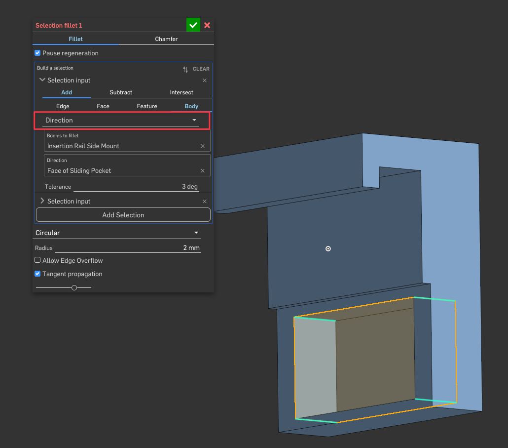

    @Derek_Van_Allen_BD Most of my functionality requirements are around smart fillet selections. I had been using Evan's Selection Fillet FS before query variable arrived.
    My workflow is usually for making parts machinable, so it's a lot of convexity + parallel + above/below a plane. This lets me select all edges per machining setup (bottom, side, top) and make changes quickly.
    My other large use case is for selecting all faces that lie on the same plane.
