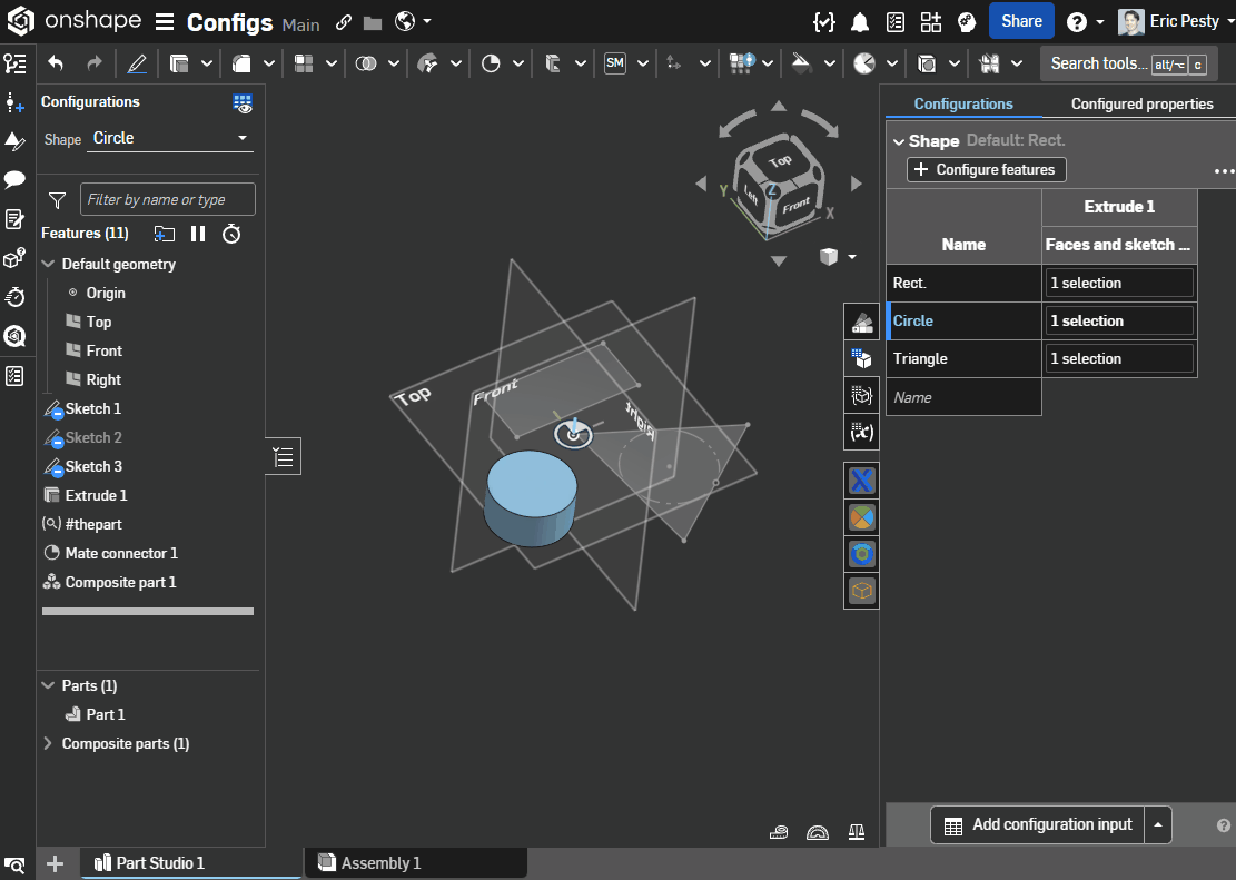

  • eric_pestyeric_pesty Member, pcbaevp Posts: 2,598 PRO
    The issue is that even though in your specific case each configuration only generates a single part, this is not a "requirement" for configurations so Onshape doesn't assume it's the "same" part. Basically your use case is a very narrow use case for a configuration system that is much broader than that and I think that's why it's not working the way you expect.
    If you use a completely different sketch to extrude a part depending on the configuration (even from the same extrude feature), Onshape will interpret it as a different part, which is a bit unfortunate… The simplest way I can think off solving this would be to create a composite part (using a query variable for "all solid bodies" as the input). Then inserting that in your assembly should automatically pick up whichever solid body your configuration produces. I would also make sure you add an explicit mate connector to your part to use for mating...
    I'm not sure what part isn't working for you. Currently you do have to manually map the assembly configurations to the part studio configuration but once you this the composite part switches as expected. This could be a good application for an AI helper to automatically generate the mappings for cases like this.
    https://cad.onshape.com/documents/a43df0add559f12915a21c5f/w/a5f403f65059413c62e427ba/e/a23ce41c252d209bd6c23f48?configuration=List_Q9NZt9LBaXwgKy%3DTriangle&renderMode=0&tangentEdgeStyle=1&rightPanel=configPanel&uiState=692f21bf2a1b5f781c2bc613

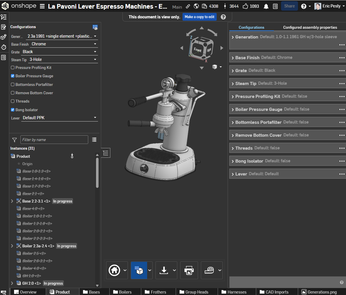

    If you look at the public model below, it does show what assembly configurations can do (I remembered seeing this one, there are probably better examples). While it would be useful for your specific example, you can imagine that building this assembly would have been a nightmare if Onshape automatically added configuration inputs when inserting each configured sub-component.
    https://cad.onshape.com/documents/4833676df7d2a808ac4b52b7/w/1779c4496f69618947b539b5/e/75f2654cbbb785c3812333d2
    While it's definitely not perfect, I'm not sure where the "irrational resistance to object oriented programming" comment is coming from! I personally think the Onshape configuration system blows away any other "out of the box" functionality from other CAD packages…
