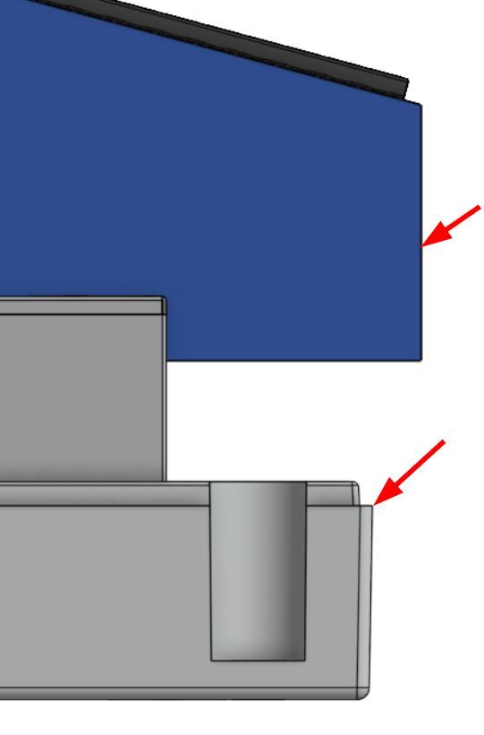

Hello,
How to vertically align the blue vertical surface (surface is going "into" the screen) with the most right corner of the gray part in an assembly? Note that the grey surface has and angle to it.
Thank you!
Greetings
Stefan

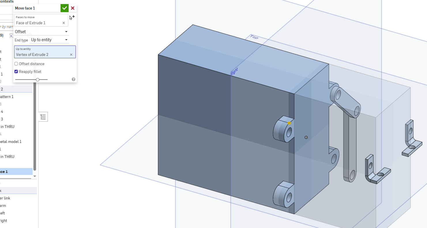

  • S1monS1mon Member Posts: 4,082 PRO
    You can create an implicit mate connector on the surface of the gray part which is perpendicular to the screen, and rotate it 90 degrees. That should give you the reference you need to mate the blue part, either with a planar mate or some sort of fasten mate with some offset.
    Move face up to entity should do the job.
